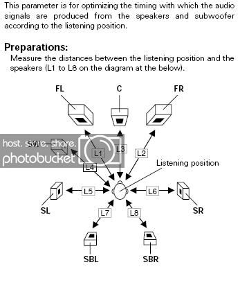

I will try to find the diagram for ya...
Here ya go:
also, ensure that the rear left and rear right speakers are at an angle pointing at your listening position (your mug)

Also, there will be a lot of tweaking as far as time alignment is concerned. According to this diagram the left and right surrounds do not have the same distance from the listening area. I trust your receiver will let you do this.
