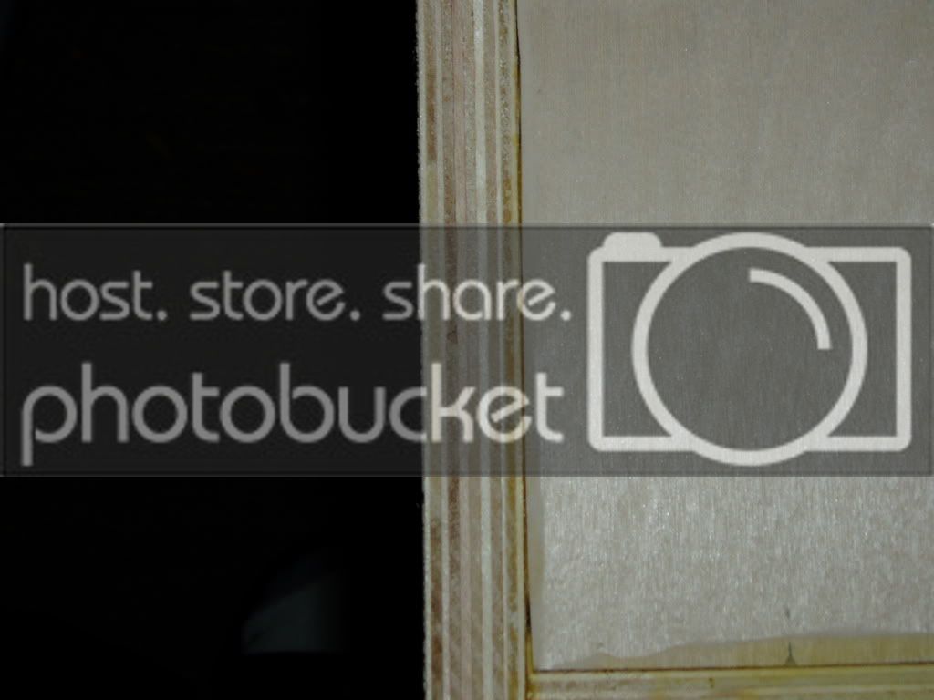

Here's a pic of the stuff I used on my new box.
$40 at home depot
Has more voids in it than the last sheet I used, but the stuff still rocks.
