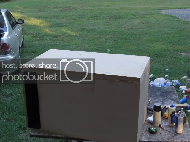

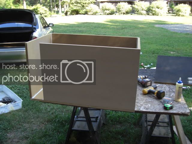

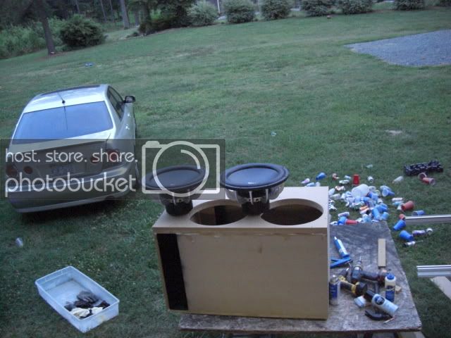

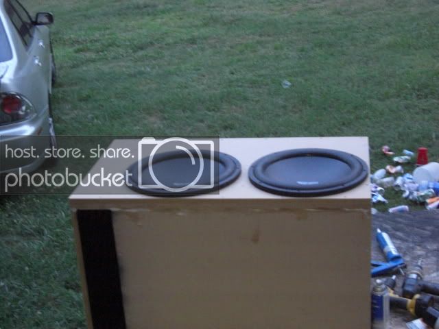

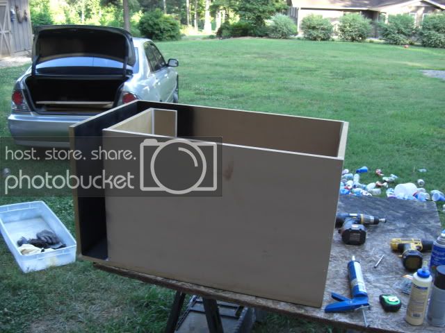

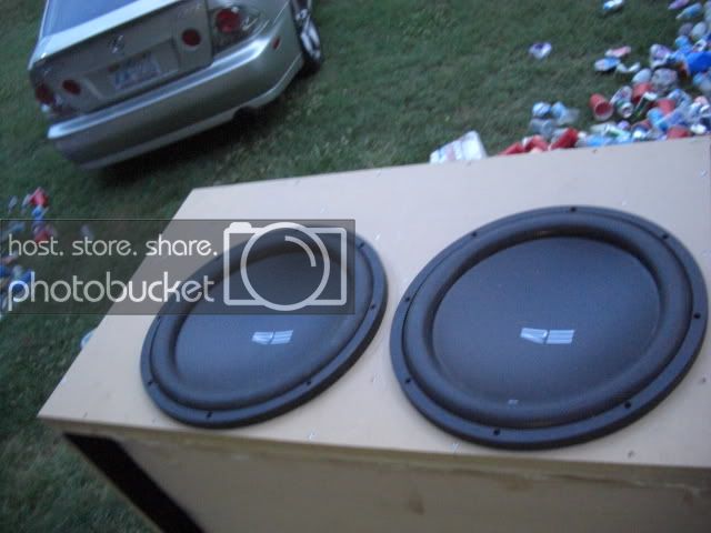

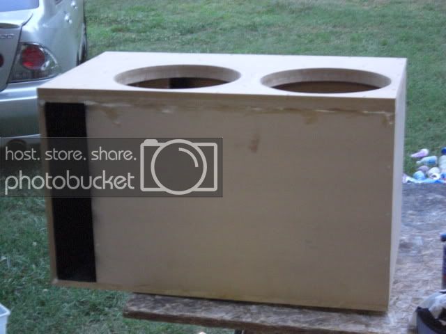

Enclosure is 7 cubes tuned to 31.5 hz. Has a 4.75" wide port with 97.5 sq. inches of port area! Externally it's 37.75" wide, 22" high and 22" deep. It's subs up and port back. Enclosure is double baffled with gold plated, set screw down style terminal cups accepting up to 8 awg speaker wire. Enclosure is not carpeted but he will put truck bedliner on it! Should turn out quite nicely!
This is going in a newer model Chevy Blazer iirc. We installed a 9.1 @ 1 ohm running them (aorund 750 wts rms each as the SE's are d4's). Has all 0 awg wiring in the truck. VERY loud and LOOOOWWWWW! Did a 142.7 with music (low bass song). Nice score considering the freq. of the song, the tuning, a tad less than 1500 wts and stock alt and battery! Wish I could've gotten a video the hatch and roof flewxing:eek:!

Nice build for sure. Thing gets loud and definitely low. I'm very pleased with it so far. Will make sure I get you some pics when I spray it with bedliner. If I can find my camcorder I'll even try to get you a flex video. Haven't seen the **** thing since I moved though =/ Back window and roof moves a LOT on low notes. Had a guy at work want to hear it yesterday, when the bass dropped he was like god **** that's loud. And he was standing outside haha.
