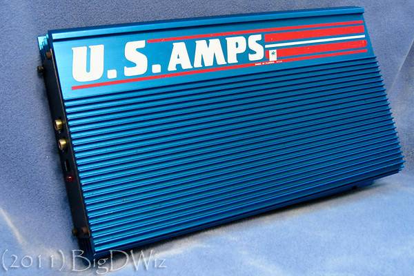

I recently bought a MINT 1992'ish US Amps 50HCA, which was sold to me as a USA-50HC. I think there has been much confusion over this amp style as I've seen 2 others just like mine for sale and they used the USA-50HC specs instead of the 50HCA's. My amp has "50HCA" on the circuit board and I found the model listed in the 1992 CA&E Buyer's Guide. I'm not sure what year the USA-50HC was introduced.

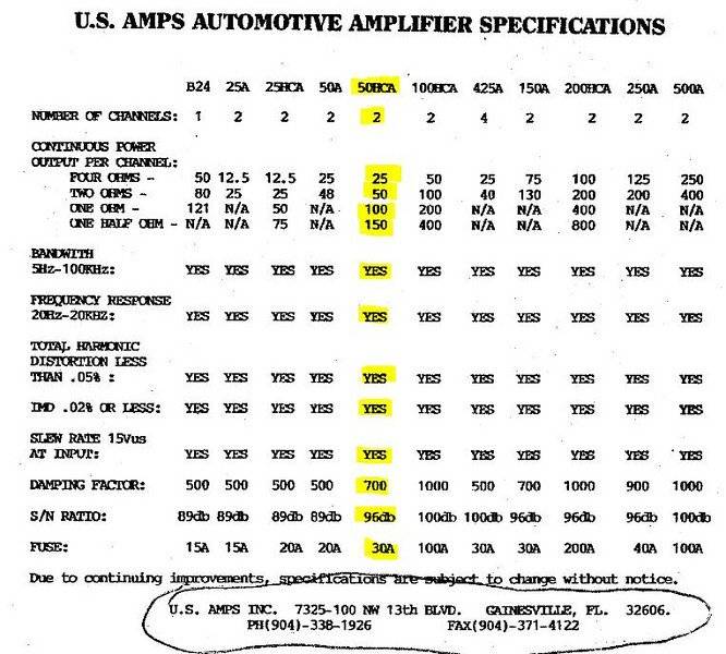

I got a spec sheet directly from US Amps and my model has "50HCA" marked on the circuit board.
So, what's the big deal or difference between the two? Well, my 50HCA uses a 30A fuse for power protection, while the US-50HC requires a 75A fuse! The ratings are very similar
The 50HCA's specs from US Amps are the following:
And here's a pic of my amp; US Amps 50HCA:
2 Questions:
1) Can someone verify my research above is correct

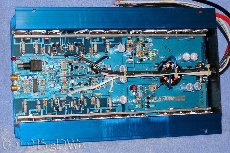

the quickest way to tell, is to actually take a look at the board, circuitry, and take output voltage readings, really. there was a period where they actually cloned the orion hcca cheaters, before getting sued, and changing them again. the time they changed them, they moved to no lettering, and "x" series. i know someone knows a lot more about them than me, and hope they chime in, but it would like to see the gut shots of yours. btw, the ratings are seriously underrated, and at low voltage
Thanks for the info, I should have posted a guts shot initially, but here ya go:
BTW, I'll test actual output power very soon using my setup:
ah yes, same basic guts of the 150x of 99, or close to that year. bit more stable p/s, and lower capcitance bank, though. that means that it can take a little more abuse, but have lower peak output. my ps bench setup took a dump while i was trying to bench one, but i got 306.25w @4ohms bridge; 10v power. 2ohm bridged got 420wrms @9v ps...... you should expect to see similar, and 0ver 650rms somewhere 12.5-14.4 volts. if i get the time soon, i'll set up my 200x and see what that really does.

30A fusing sounds low - I have a 50HC and it has 75A of fusing according to the manual... I thought the HCA was higher-performance?
edit: didn't notice you mentioned this //content.invisioncic.com/y282845/emoticons/tongue.gif.6130eb82179565f6db8d26d6001dcd24.gif sry. still... oddity.
