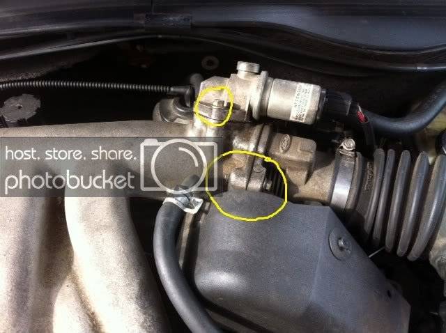

will these bolts work to do the engine ground?
