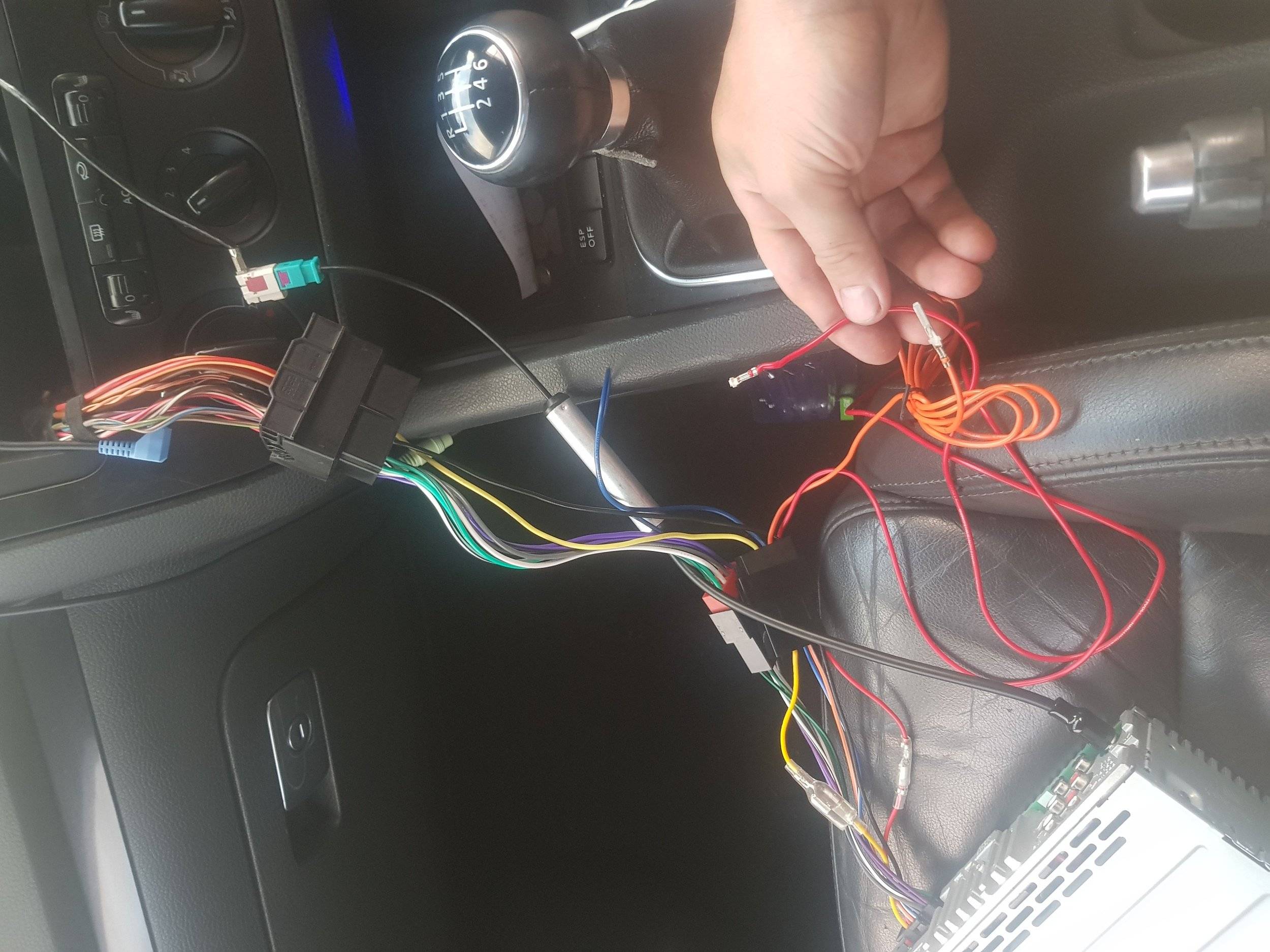

In need of help theres a red and orange loose wire that isn't attached to the stereo it was working looks to me like it has come loose from somewhere can someone please give me an idea all fuses are ok it's a mk5 golf cheers

Yikes. The pins pulled out.
Need the year of the car to determine.
Red is Ignition 12V. Orange is Illumination. You don't need Illumination for it to work, but you do need the red ignition wire.
