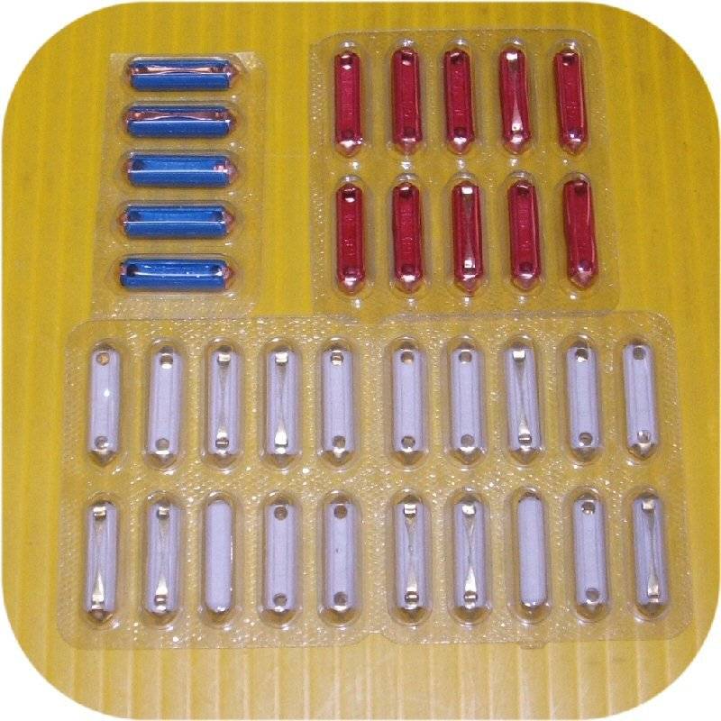

and the way the electrical is setup on them is thru odd relay setups. constant power actually shuts off lol so much for constant power! have you seen the funky fuses the old european cars use? weird shit man. 22 yrs as a tech I never saw such a mess in my life as they are lolz.
You mean these ? //content.invisioncic.com/y282845/emoticons/biggrin.gif.d71a5d36fcbab170f2364c9f2e3946cb.gif
No idea...
