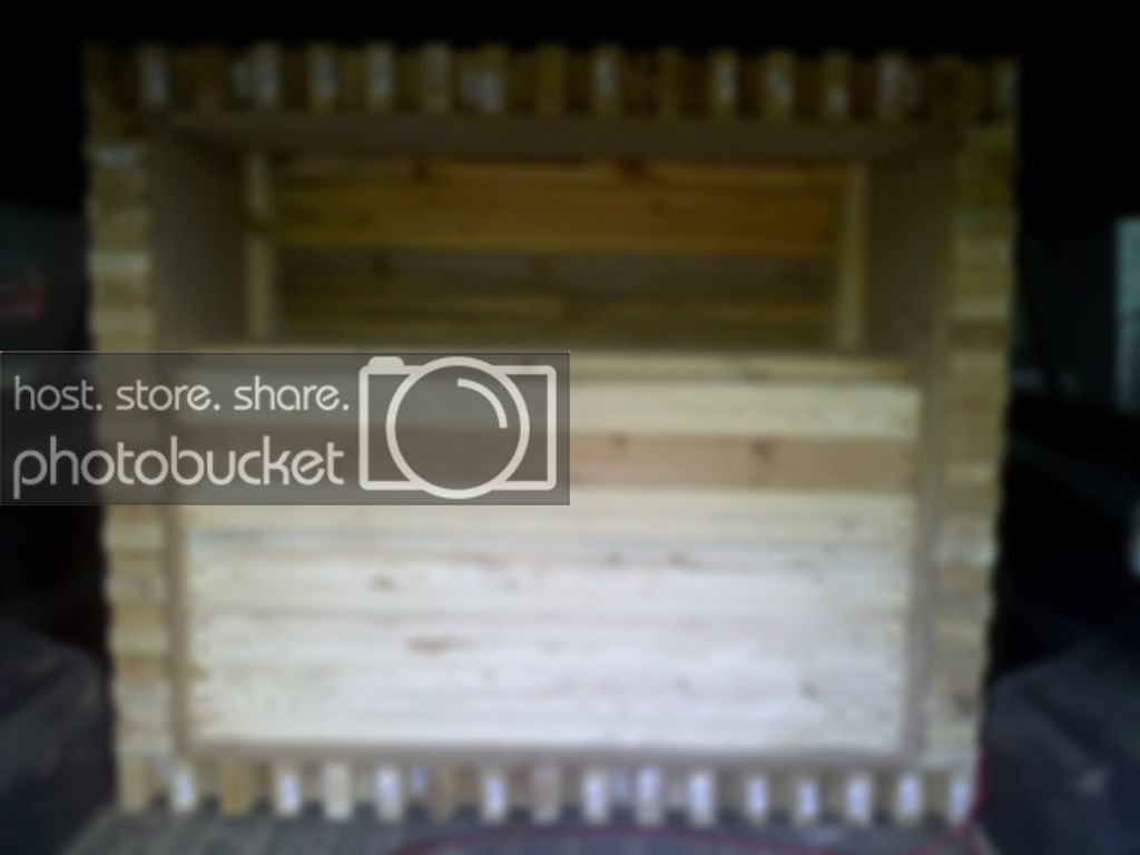

might be playin by tonight but obviously not even closed to finished. fillin gaps and what not still //content.invisioncic.com/y282845/emoticons/smile.gif.1ebc41e1811405b213edfc4622c41e27.gif

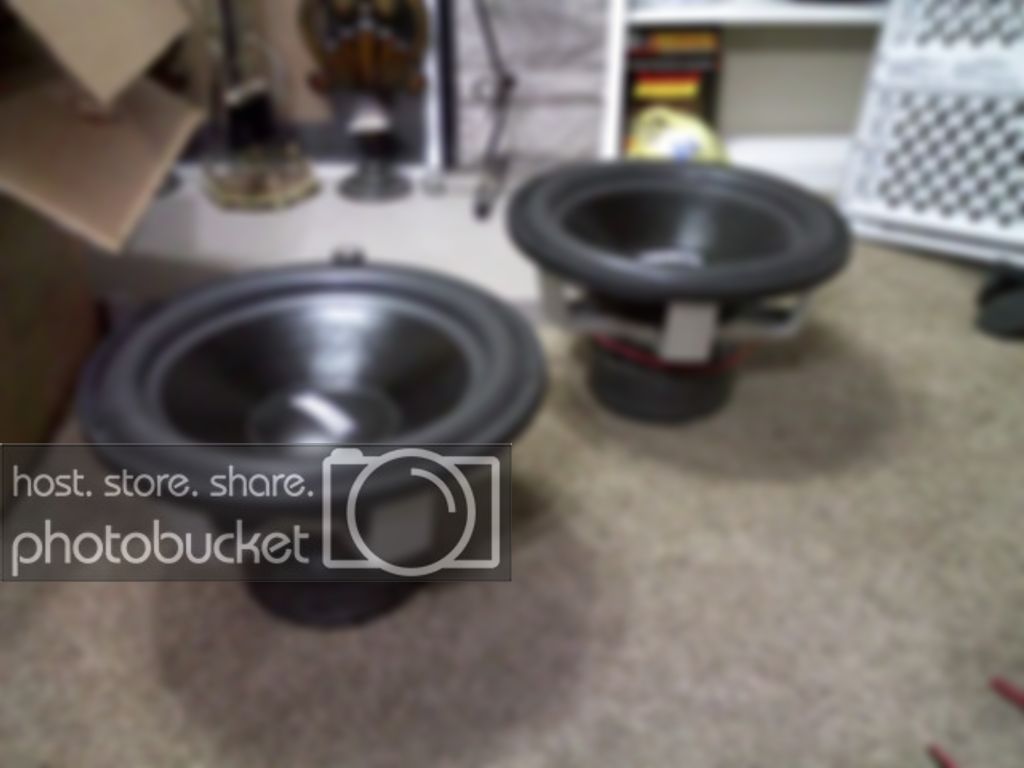

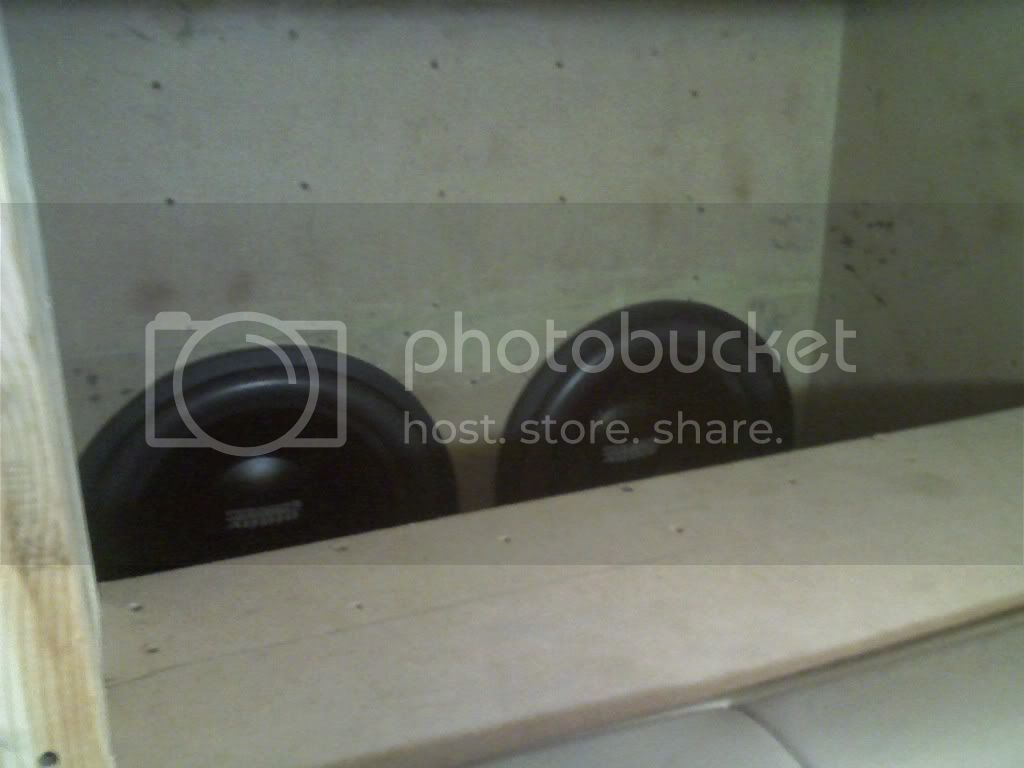

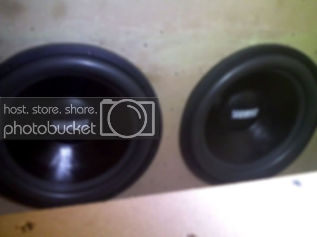

subs are all wired up just not installed yet and amp is already hooked up so its just a matter of liquid nailing all my seams and installin the subs.
its playin //content.invisioncic.com/y282845/emoticons/wink.gif.608e3ea05f1a9f98611af0861652f8fb.gif had a problem with not having big enough screws to hold the subs haha. so i gotta go find a place right now that has something i can use or use washers.

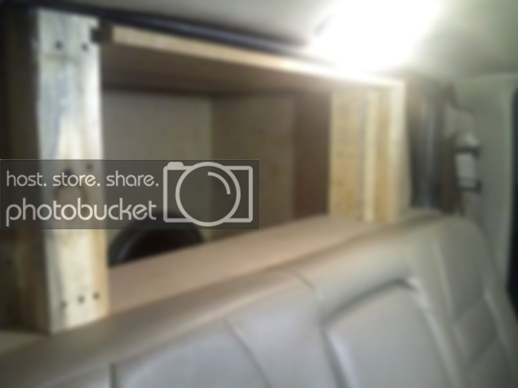

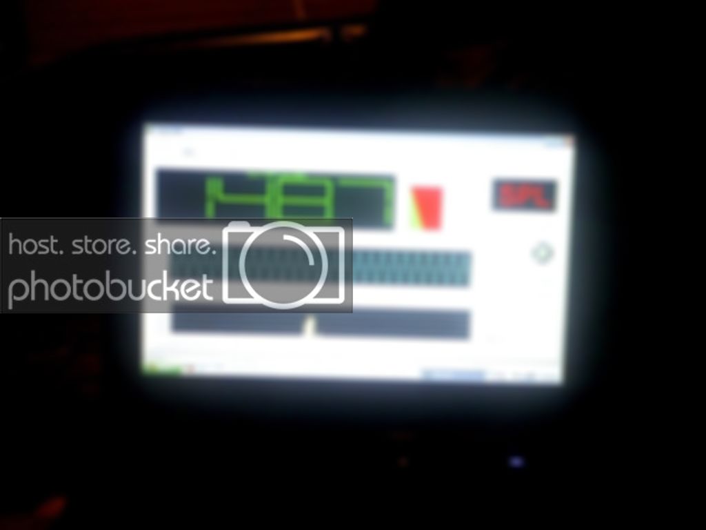

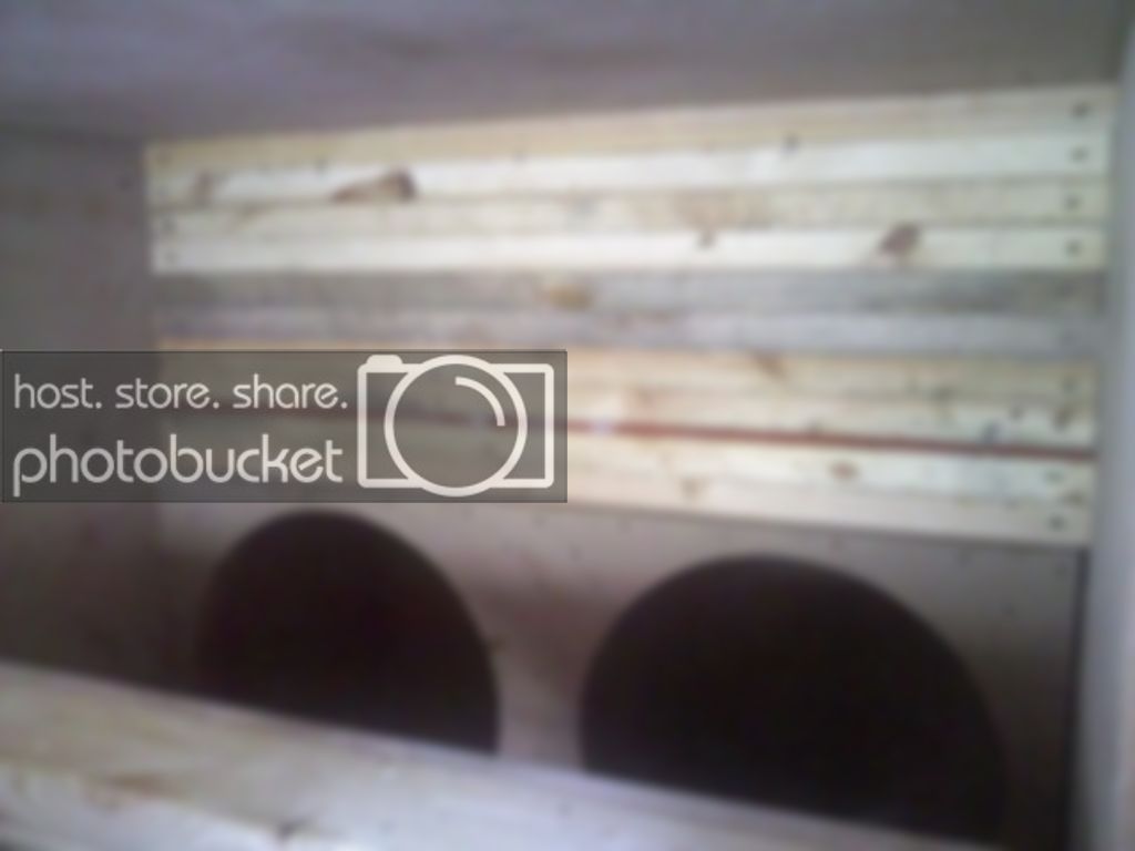

too high. but for no port tuning its not bad. 52-53hz peak. that was while playin bass mekanik - bass mekanik.

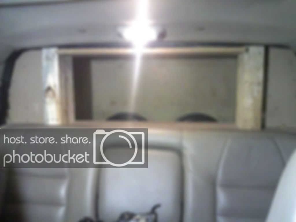

as soon as i seal the box off from the back ill find my peak then adjust port from there. right now my port is 41.75" wide x 16" tall. so its tuned high.
definetly sounds louder than it shows but im not complaining.. if i break a 50 ill be happy.
small update. its gettin louder lower but peaking higher but still louder. i was peaking at 53hz doin a 148.7 on bass mekanik-bass mekanik. but now im peakin at 148.8 at 55hz while playin Kia Shine - Crispy.
while ive gained 2 db while playin Lil Jon - Push that from a 145.5 to 147.7 so im gettin louder lower so the range is getting better.

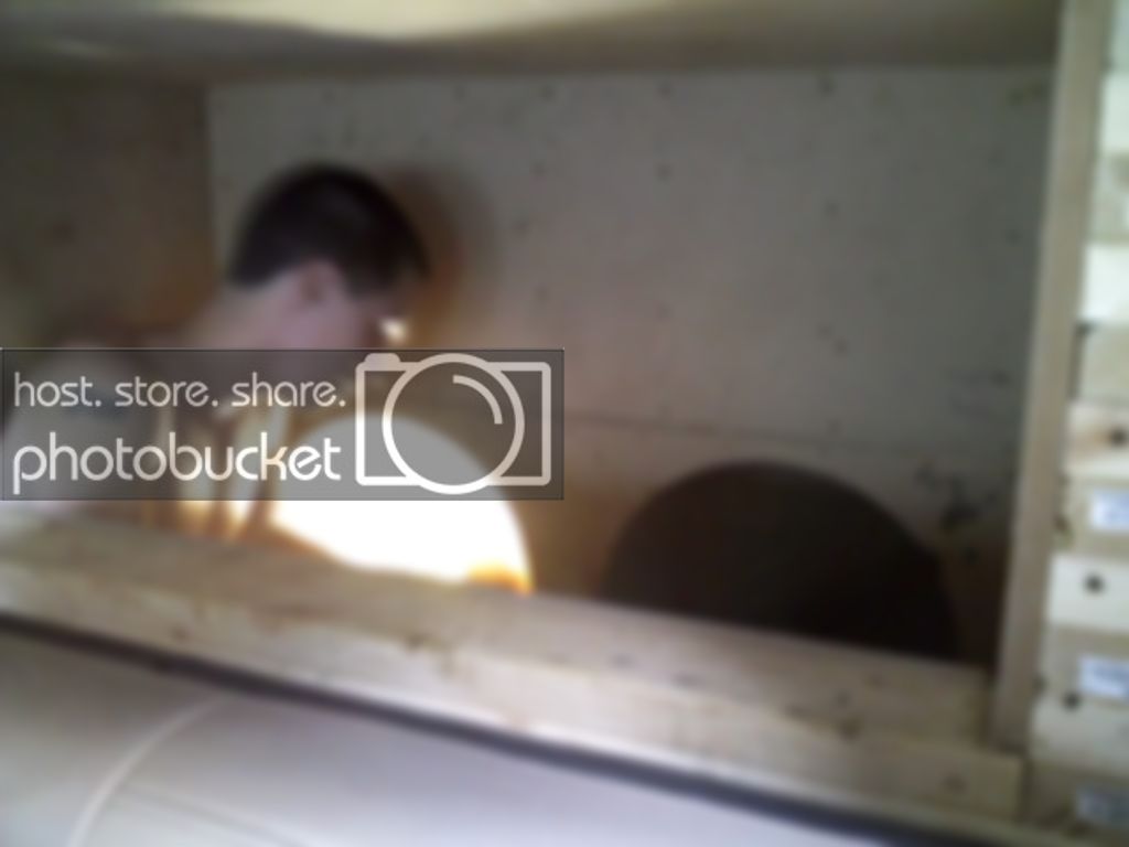

im not in the mood to tear out the wall above the sealed chamber to make it larger so im gonna keep tryin these port mods which are working right now so far. the subs are screaming for more power though. barely moving.
still have to completely seal it from the back.

Powering the Nightshades with the mm4000.1? Figured that would be enought power for them, but I guess not lol.
Nice to see an updated, its getting there. Great score too //content.invisioncic.com/y282845/emoticons/smile.gif.1ebc41e1811405b213edfc4622c41e27.gif
when I had Jacob rebuild them I had him add a 4th spider because I was going to run a 3000d to each
Ahh.. that would explain it then, thanks.
