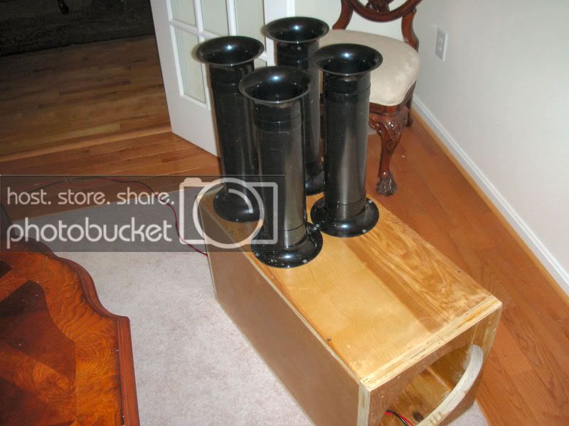

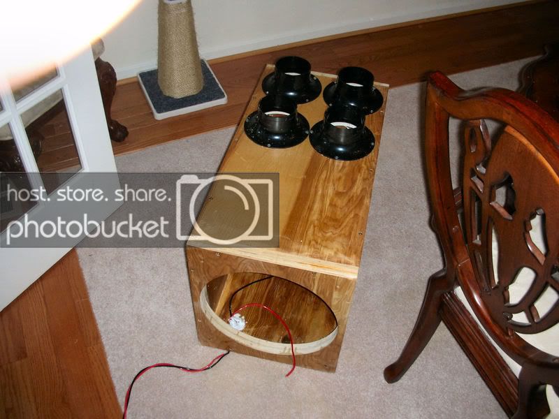

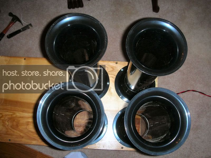

Pretty bored so i thought ide show you Teh Wang BoX
This box is for a fully loaded 15" BTL
Specs:
3.75 Cubes Net
Tuning of 38Hz

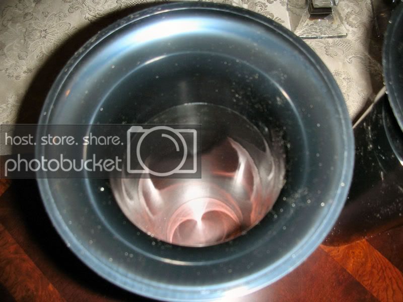

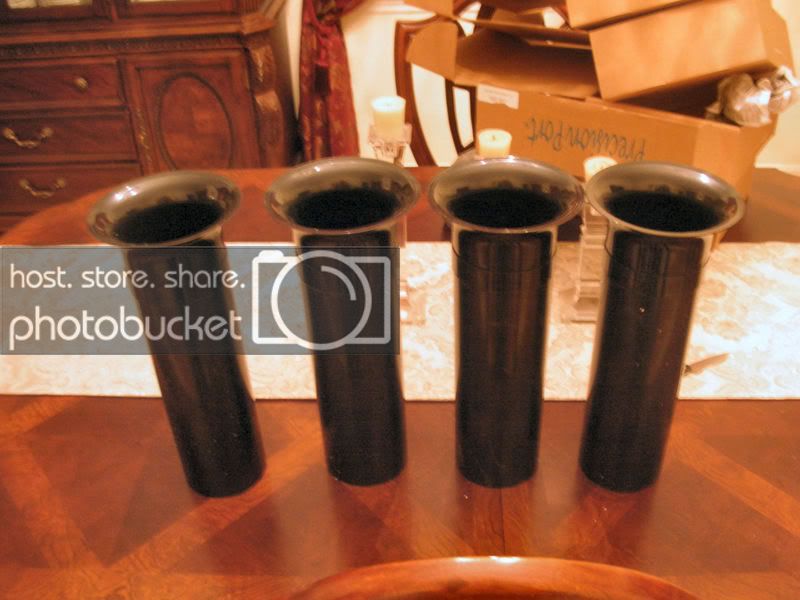

Utilizing Four 4" External PP Aeroports

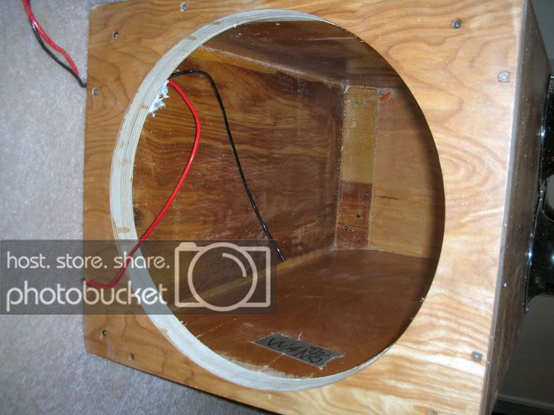

Box is Made out of 100% Birch
The Baffle is Double Birch Baffle
Fully Resin'd on the Inside
This box is designed to waaaaaaaaaang the 40hz region and have a slow dropoff under tuning, it will play down in the Soul Survivor Region w/o Problems so i dont want anyone to think its a pure SPL Box because it can still play down there, but it was designed with Daily SPL in Mind ( Hence the External Aeroports ) And to absolutely hammer where it counts (40hz regions / jeezy / Lil John / ETC )
Teh PiCz!!
wheres the fiberglass? //content.invisioncic.com/y282845/emoticons/confused.gif.e820e0216602db4765798ac39d28caa9.gif
No Fiberglass it wasent necessary, it was Resind on the inside to make it Smooth, Fiberglass wasent exactly necessary because its a birch box anyway im not worried about making it stronger
Its going into a Chevy Impala, i have the rear deck gutted out and the back seat taken out so it should be pretty wangin, especially since im throwing 3800W too it
