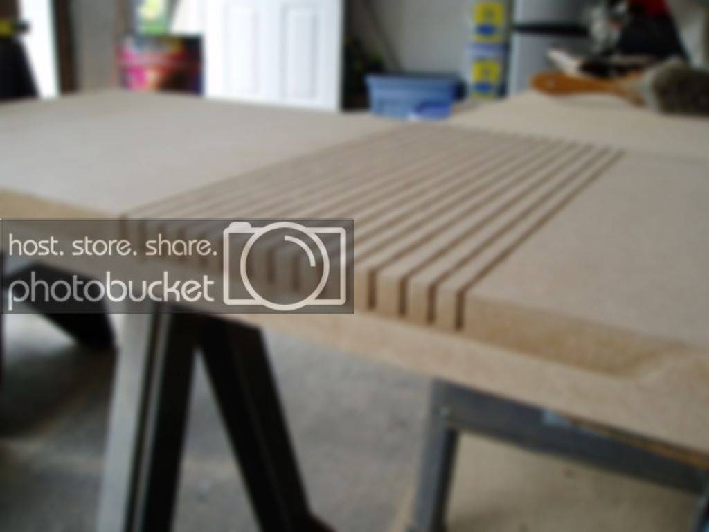

Being a n00b to flared ports I got a scrap piece and practiced on that. Confident in my technique, I assembled the box, leaving the flared port wall last.

Also, keep in mind that I don't have a table saw either, so that was done with a circular saw and a guide that I rigged up.
My nice cuts

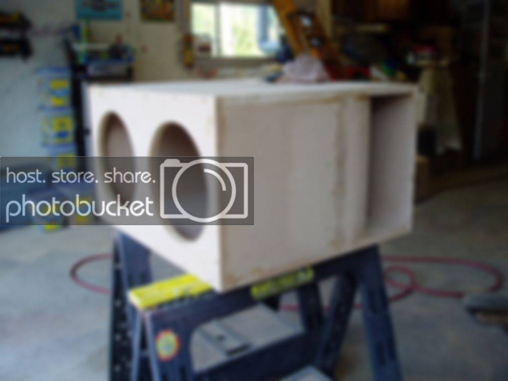

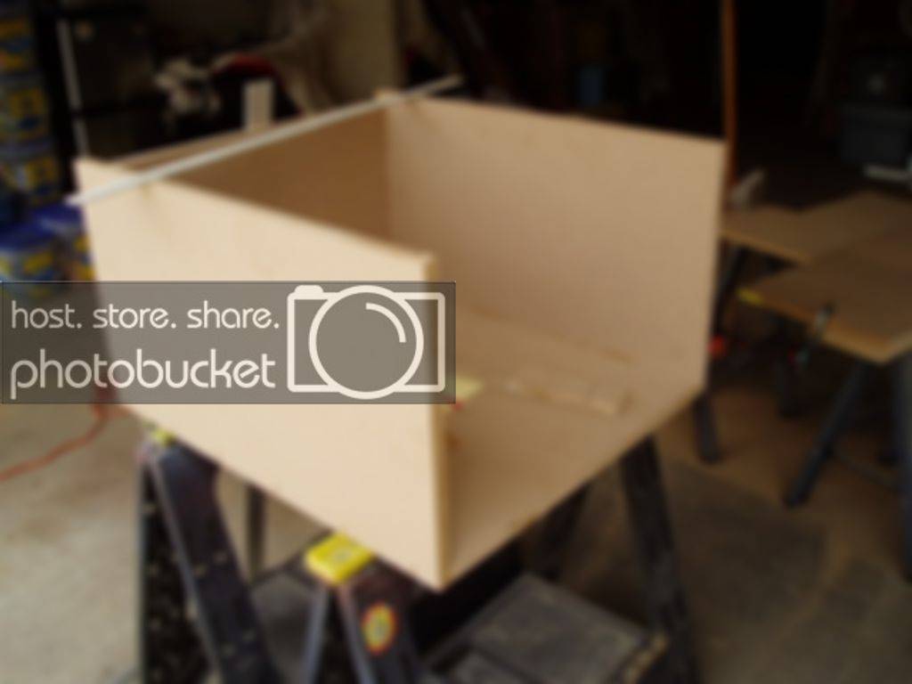

Box assembled minus the port/side and top

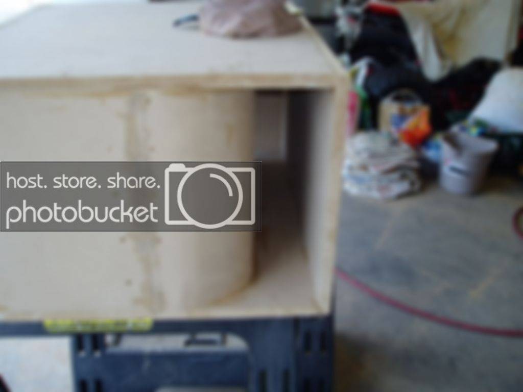

The finished product
Shot in the port
The aftermath. Another drawback of doing a flared slot port.
And for those of you worried, yes the inside of the flare is reinforced (kitty hair) and that joint you see between the side and the flare part is filled in with the good 'ole sawdust and glue mixture.

The second port just has a joint where it meets the side piece (that line inbetween the two rows of screws) instead of being one solid piece like in bonesninja's pic.
i managed to make the whole port and front side of the box 1 piece tho
That was my original intent, but having that piece break in half and not having enough wood for another attempt forced me to do it the way I did. //content.invisioncic.com/y282845/emoticons/frown.gif.a3531fa0534503350665a1e957861287.gif
