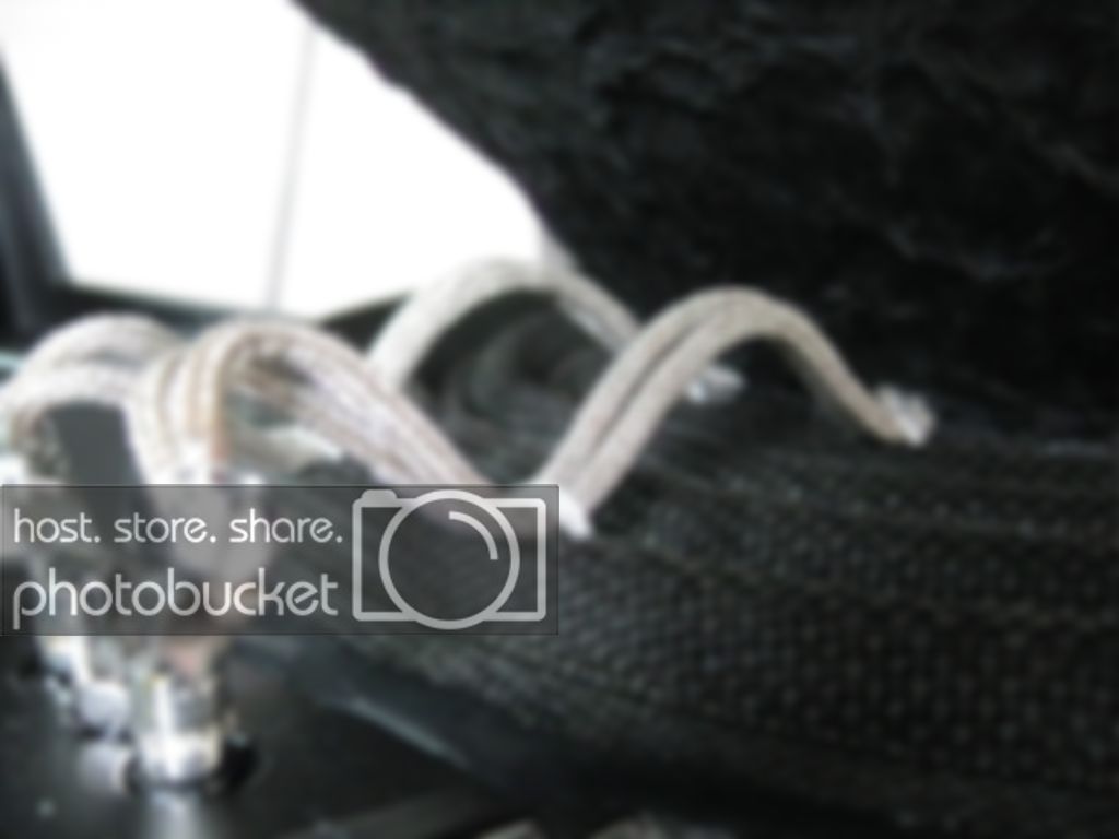

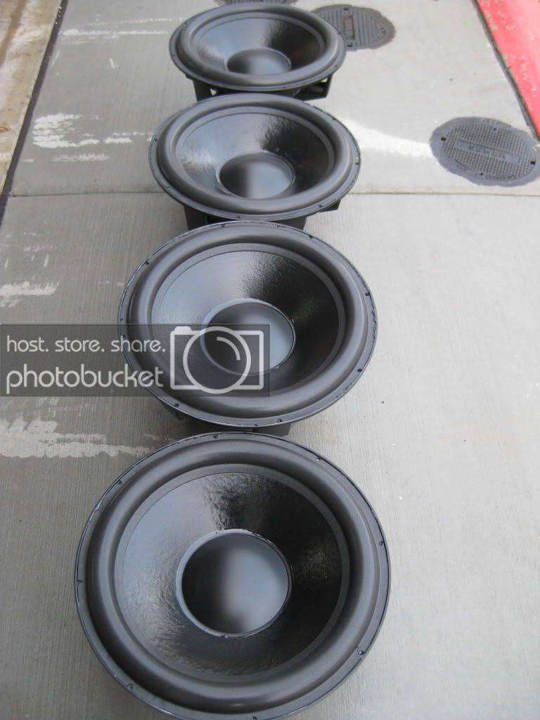

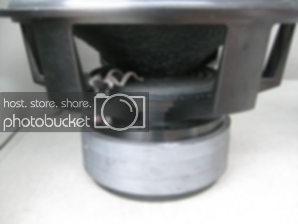

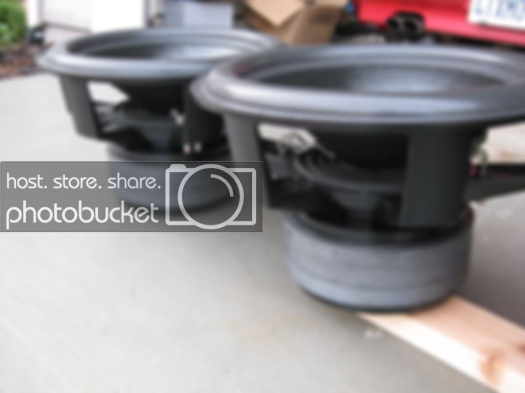

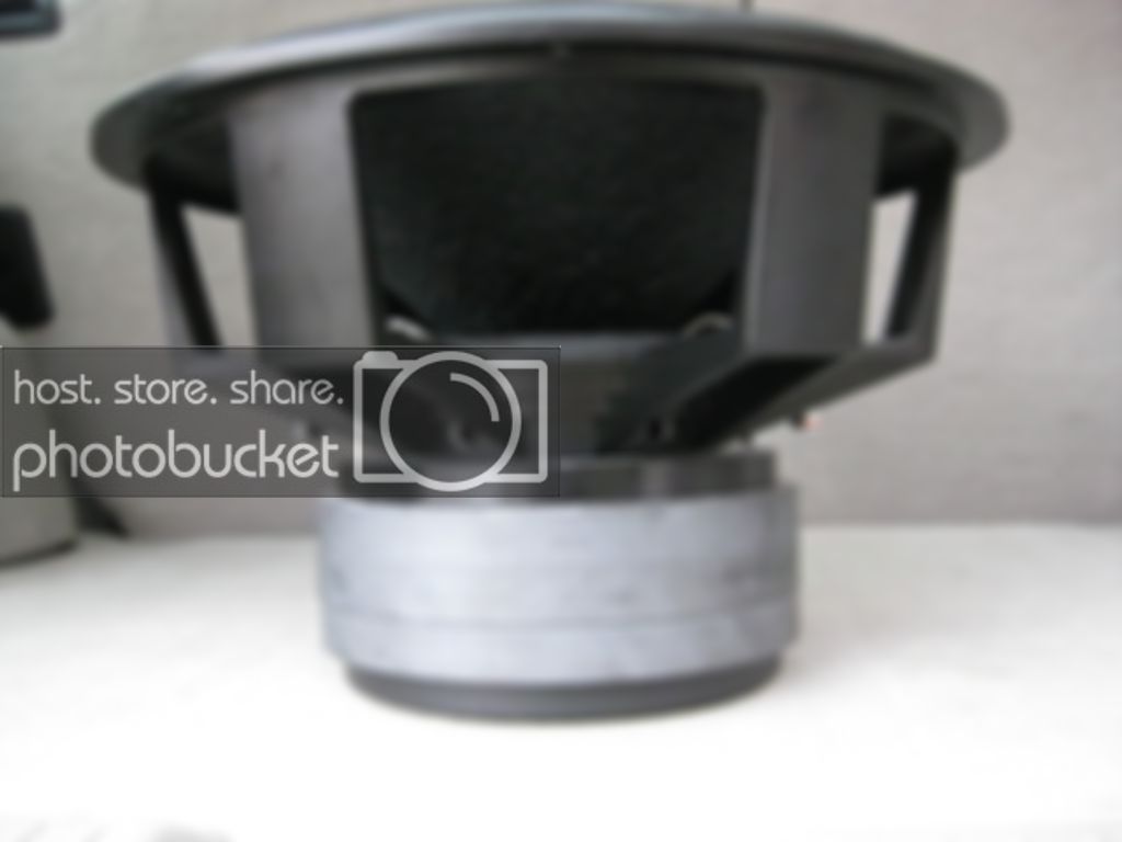

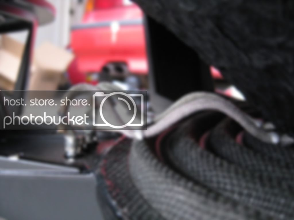

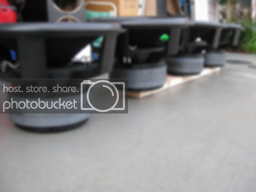

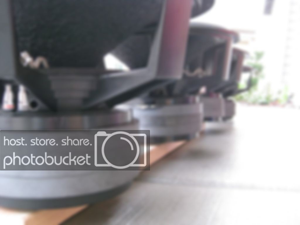

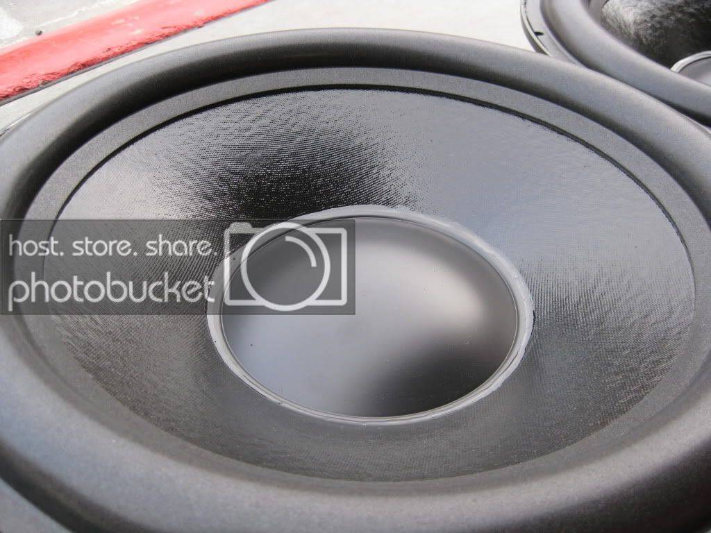

Finished these Madmax's for a local last weekend. They will be powered by a couple SD 12kds. Should be pretty loud once he is all finished.
Nice leads, Xerox. //content.invisioncic.com/y282845/emoticons/smile.gif.1ebc41e1811405b213edfc4622c41e27.gif//content.invisioncic.com/y282845/emoticons/biggrin.gif.d71a5d36fcbab170f2364c9f2e3946cb.gif:p:
They look nice man. What type of bolts do you use in those motors? What coils are in them?
he doesn't compete... and apparently doesn't care about he's ears and/or ability to breath while driving! My kinda man! Kudos on the nice build
HAHAHAHA!! Thanks Dave!
I used 5/16 machine bolts. Memphis love's their changable top assemblies lol. It would have been cool to mod the baskets to allow for that on these.. Maybe next time. I used 4 layer 4" coil with a 2.25" WW and vented former.
