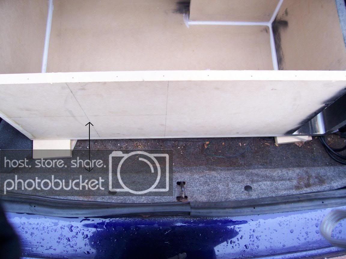

How much space from the surface of the box to the back of the trunk do I need so the sub will not hit it?
Pic of what I am talking about.
personal prefrence is to have the subwoofer diameter from any surface, if you are just worryed about the sub actualy hitting the back of the trunk, look at the specs of the sub. the one way excursion of the sub is usualy stated in mm.
