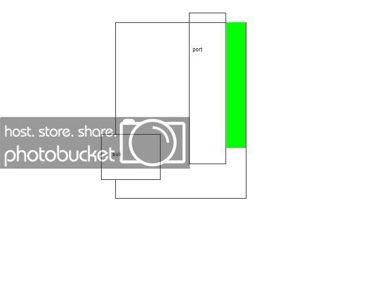

it's a chevy colorado, the old box actually was pretty great after i ported it, it was 49x25x20 11 cubes gross, about 8 cubes after displacement with 5, 6 inch aero's tuned to 30hz.

ya if your ports were each like 40" long
area in green is dead airspace, 4 inches, by 18 inches, by 49 inches
+the ports themselves, and the woofers = 3 cubes of airspace.
