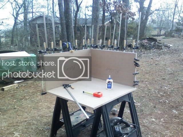

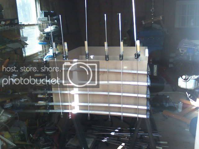

I got MAZZASEC's (Matt) box finished up and he came over so we could hook everything up and get it playing. Worked out pretty well except for the 2 trips to walmart for screws lol.

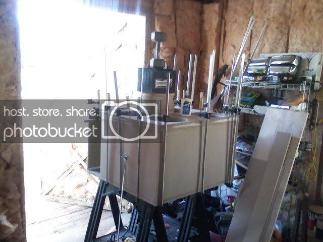

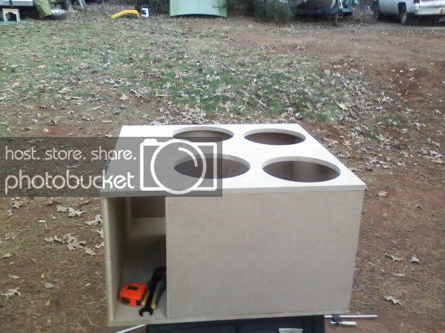

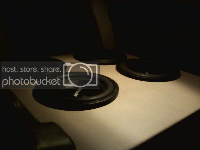

Woofers are 4 12" RD Alpha's on a proto RD 9.0

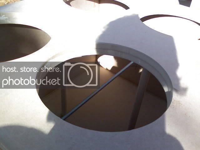

6.9 cubes tuned to 32.5hz with 140 sq inches of port and lots of bracing.

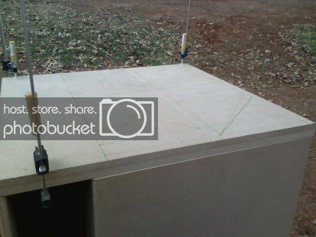

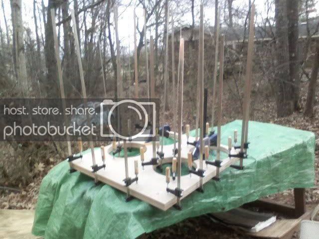

1st baffle

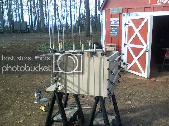

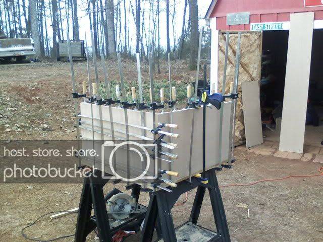

gonna be strong now!

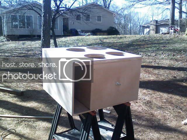

so close to completion

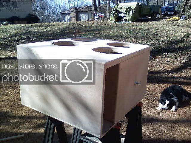

clean
done

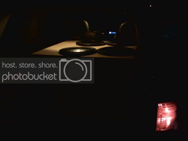

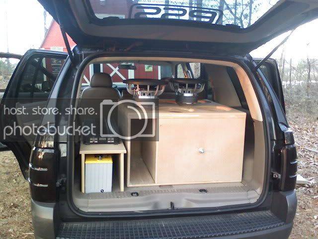

in and looking clean

Not even tuned in yet or all the way screwed down lol and it wangs hard
Thank Mike I appreciate it! Matt seemed to be happy. I ran outta drill power and they were only 3/4 the way in and Matt proceeded to turn it up and see how loud it was in the walmart parkin lot haha. The subs werent screwed down far enough and were leakin so so bad haha and it was still painful to sit in. Should do great on the meter in bass race and bass boxing!
