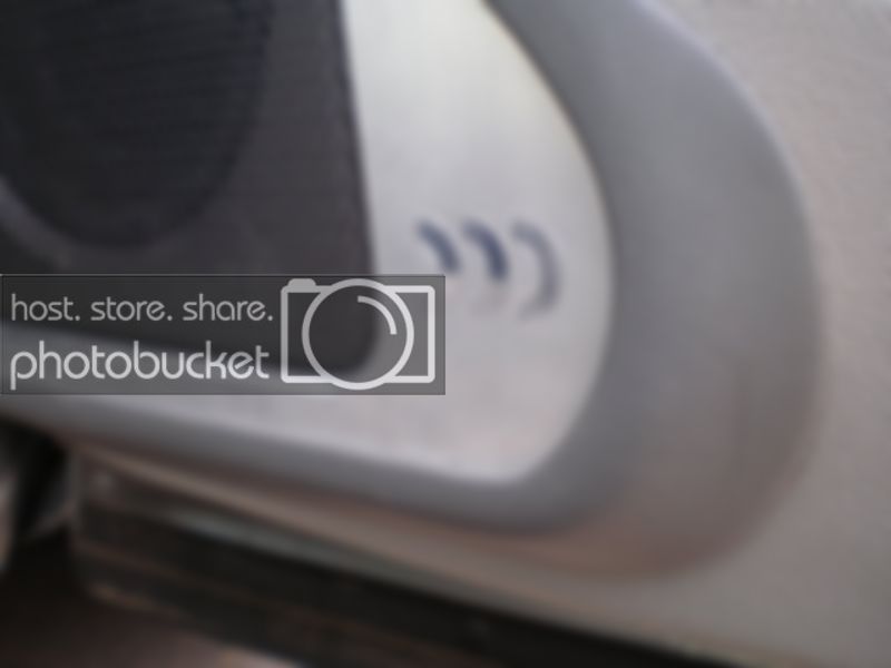

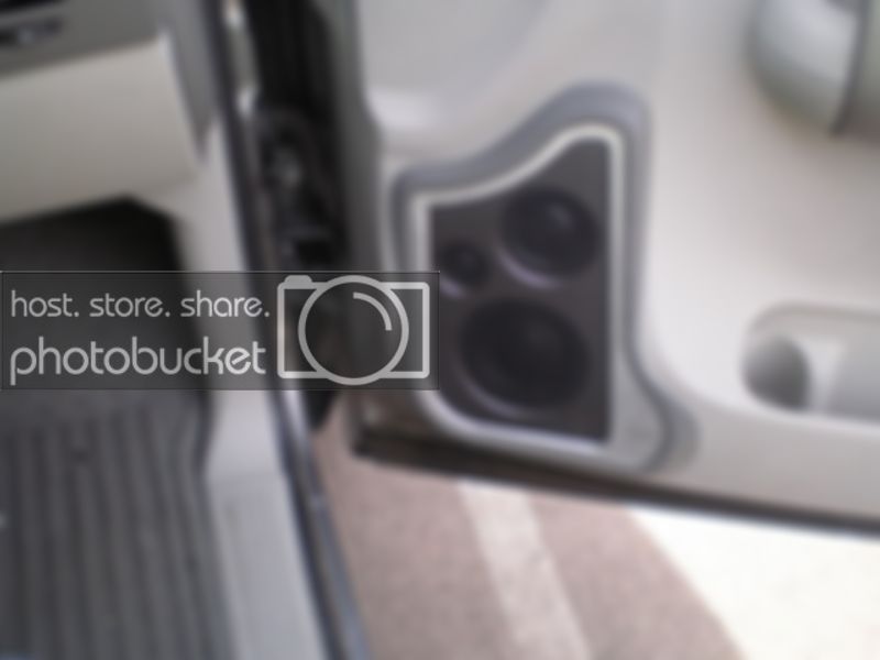

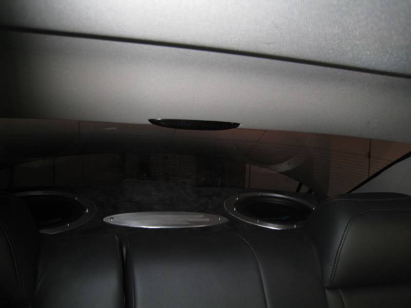

Here is a quick write-up I did (on another board) on a few things you should know about machining/routing aluminum alloys. You might ask why this was posted on a fiberglass/car audio site. Aluminum, when worked correctly, can instantly take an install to the next step. There are many different ways to incorporate this material into installs, most of which require routing. As I have more experience actually machining aluminum than routing it, I will go over some basic things you should know that are similar between the two. Before I do that, let's take a look at some installs where aluminum has been incorporated.
(Courtesy of Jon Kowanetz, Handcrafted Car Audio)
(Courtesy of Chad Marra, Xtreme Audio & Design)
(Courtesy of Tim Baillie, HzEmall)
