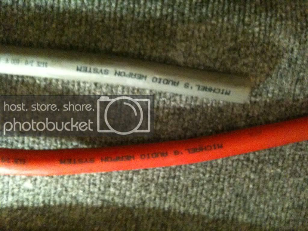

The knu 1/0 OFC is $4/foot, the knu 1/0 CCA is $2/foot, and 1/0 OFC welding cable is $2/foot.
That's what I was referring to. CCA has less than 70% of the current capacity of OFC, so the 1/0 the OP bought is equal to 2ga OFC welding cable ($1.75/foot).
i know the specs. but i wasnt talking cca either. ill take a run of the same size that will handle more. (didnt realize at the time a made the first post in this set that op had cca)

I use welding cable. $2/foot for 1/0 FTW, and it's the same thing. It'll tie knots and do everything the knu stuff will for half of the price.
If you can find a place that carries it locally, you can save some money over the knu stuff. It even comes in up to 4/0, although I haven't seen an amp or distro block with a 4/0 input yet, it's huge.
Yup, I have used all the good brands like Knu, Stinger, etc and loved the products. I did switch over the Trystar welding cable a few years back. It's the same thing, but I can get it a choice of 30 colors and get custom printing.
