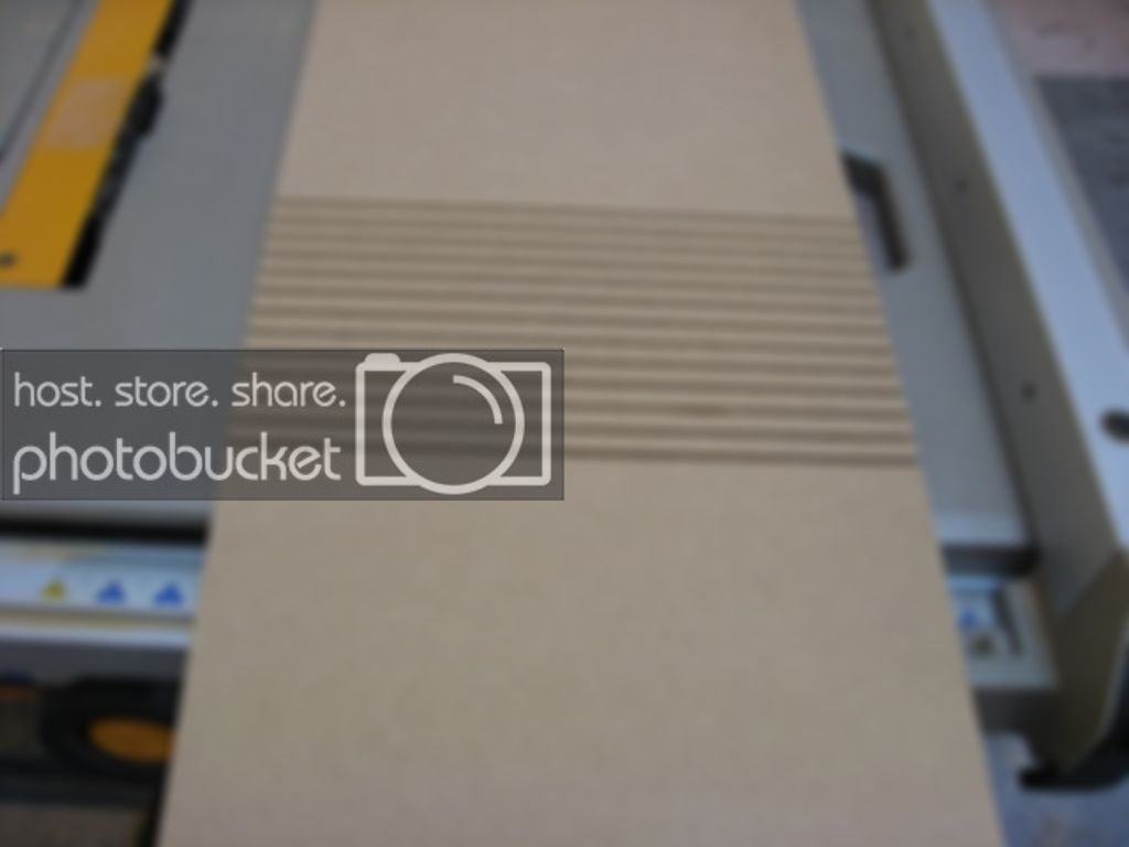

I'm going to make a box, 2 cf @ 32hz for a pair of Powerbass 10's. I'm just going to kerf the port opening.

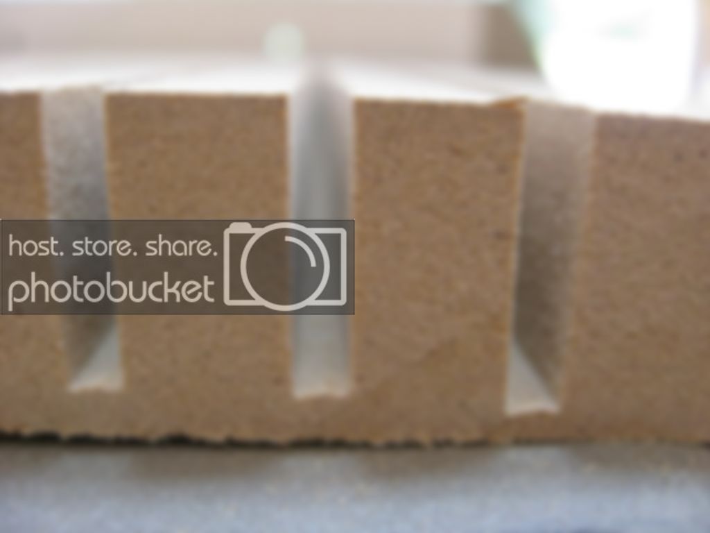

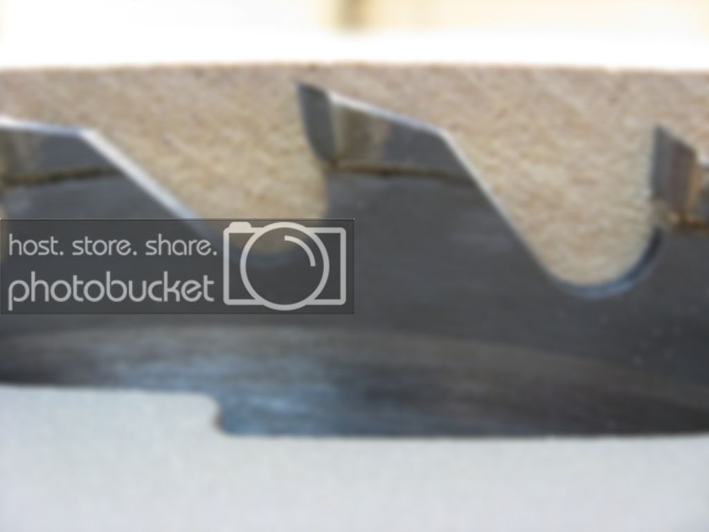

Step 1: Set the blade depth. I highly suggest having a scrap piece to test with. Should be like 7/8ths or 15/16ths deep. Just barely enough to keep it intact, otherwise it won't bend.
Scrap wood:

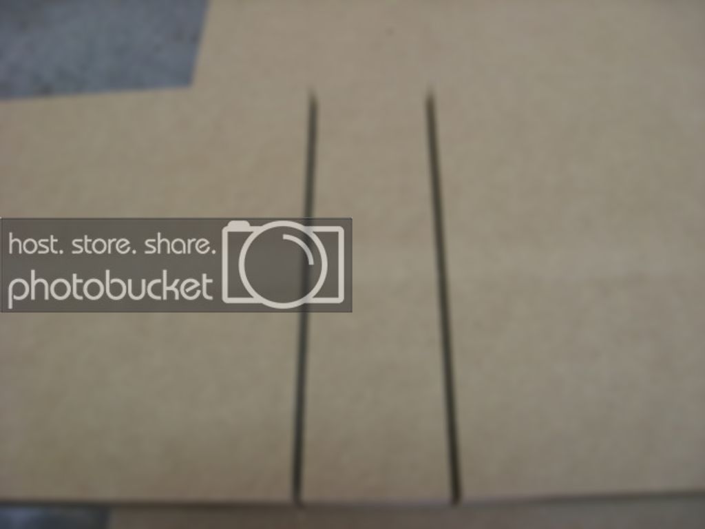

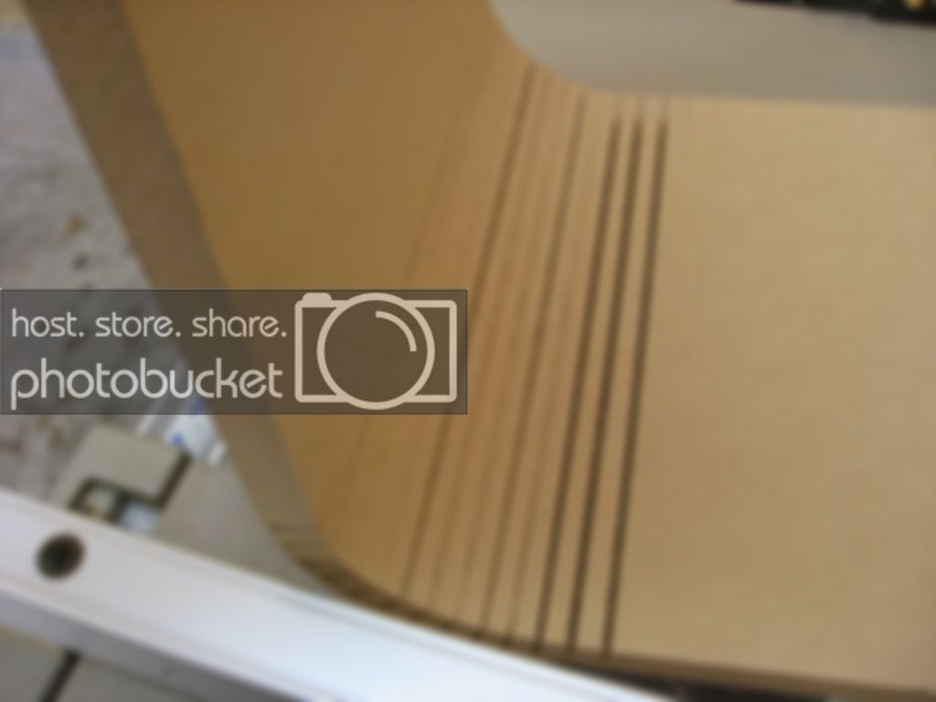

Step 2: Make cuts every 1/2" for ~5" (10 cuts) for a 90 degree bend. I made 6" worth of cuts and it was too many.
The wood should take a little force to bend, but once the wood gives a little, it should bend freely.
