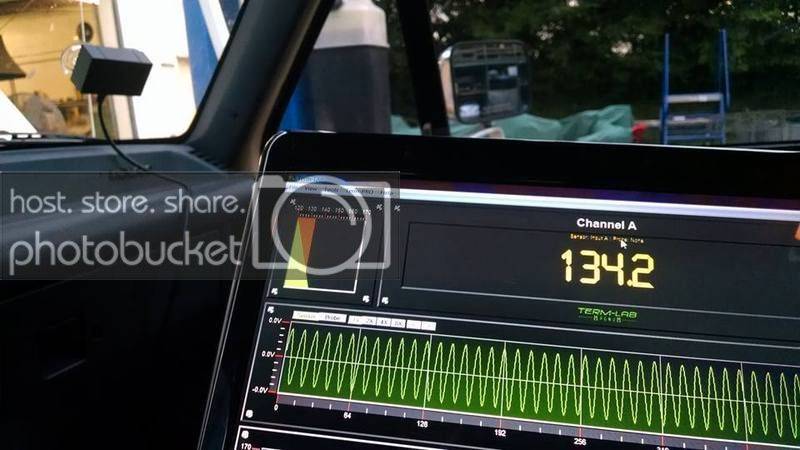

I just did a 134db, to music, in my old 91 work truck on that Kwood amp and a 16yr old used 12" sub. Sealed, on the dash Termlab Magnum ....
