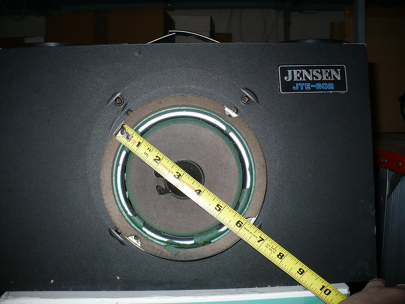

Given their age and this climate we have in the PacNW the rubberesque parts of the drivers for these speakers has rotted away. These seem to measure between 5 1/4 to 5 1/2 inches and while I could modify these particle board enclosures I'm not looking to build a thump thump system, rather just rock out on the freeway to the likes of Foghat, ARS and others. Does anyone know how to accurately detirmine the size of these speakers? What I mean is, is it by the size of the hole? The size of the mounting ring? or the distace between the mounting holes? Sorry for this simplistic question but it's been many a moon since I've component upgraded speaker cabinets.

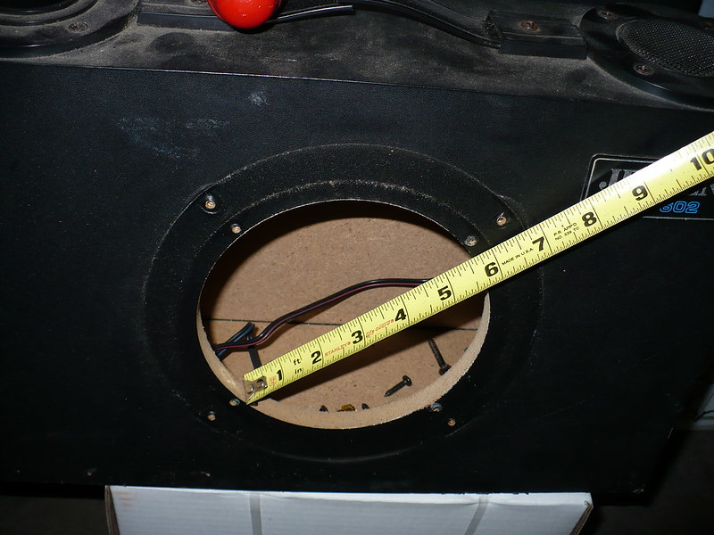

Well, I've detirmined the hole to be 5 5/8" diameter
with clearance of 3 1/2" on the horizontal. These speakers are being driven by a Pioneer 100W per channel amp. Any reccomendations for reliable speakers would be very helpful. I have I understand as terrible horrific sub standard speakers coming from Sonic Electronics on friday and, as I understand it from other forums that I should make arrangements for return of these speakers without even trying them. So given this setup I'm hopiong for a reasonable and reliable maker of 5 1/2" speakers.

The box measures 3 1/2 x 9 1/2 x 16 1/2" internally, if I remember how to figure cubic feet it'd be .29
What with the bass tube the low ends are just fine with these boxes
