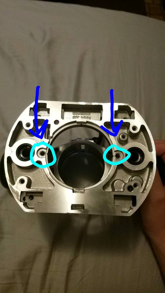

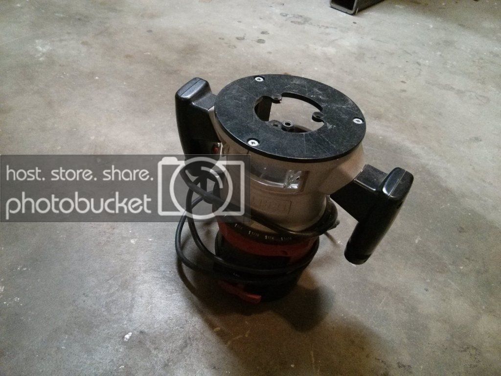

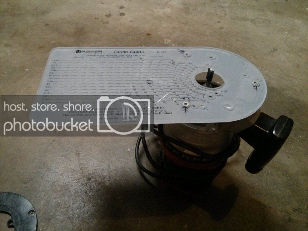

Under the black base plate theres only 2 black screws that I removed. Seems the router fits not accurate from across another but it's the only one that fits that seems to make it in the center of the jig hole. Any other holes I try to align it would make the router bit not be align with the jasper hole.
First picture is where the 2 black screws were behind the router base plate

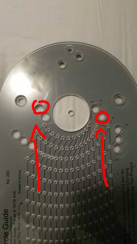

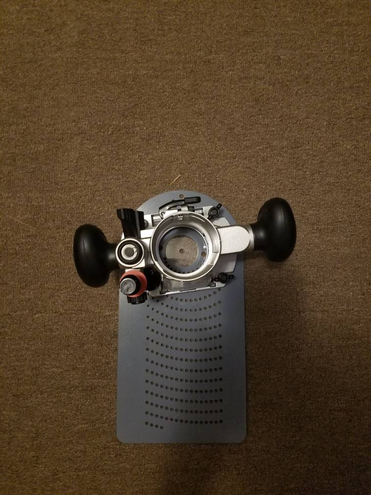

2nd picture showing where it best lines up but makes it crooked using only 2 screws to hold it down.

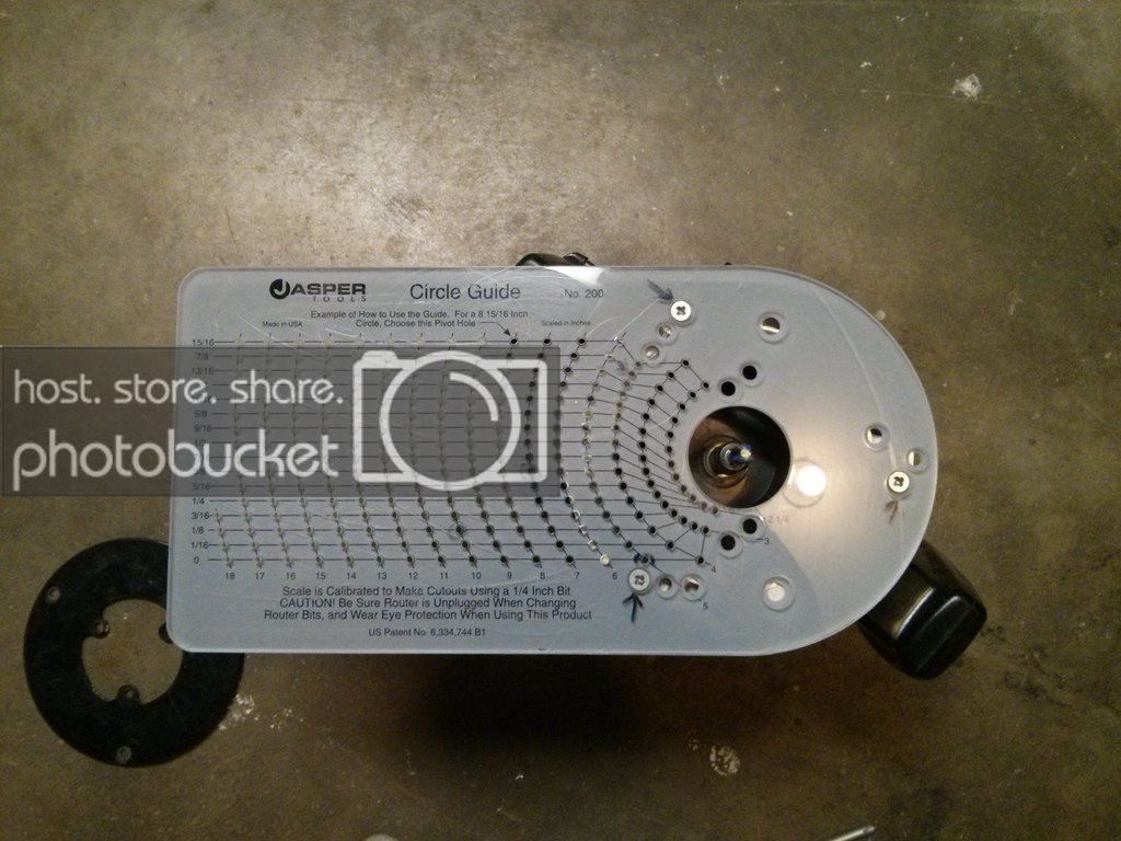

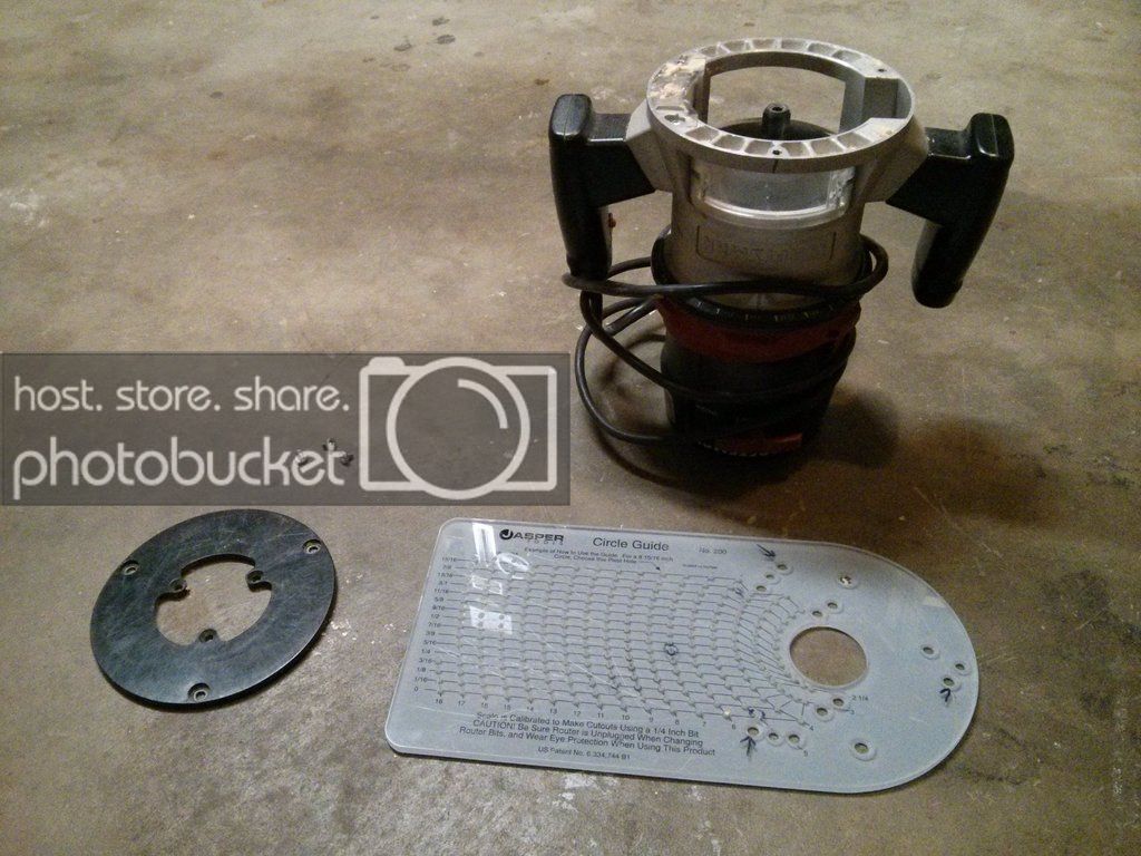

@ekah So here's a few pics of my router and jasper jig....and the 3 screws I was talking about...
I noticed you posted this same thing over at SMD Forum as well. I wouldn't trust what they said there. Unless your jasper jig is sitting flat and not at an angle, your cuts are gonna be angled.
It's crucial to use the supplied peg and the acrylic disc to center everything up the first time. Throw the calibration/centering peg in the chuck, hand tighten. Leave the acrylic centering disc installed in the jig and slip it over the peg onto the router base, line up with the screw locations. There should be almost zero play and you will know it's centered, then tighten the screws that hold the jig to the router base.
Mine is 1/8 inch off even with the proper bit size. Which is weird because the chuck sits dead center on the jig. I used the measurements on the jig as a reference but always triple check before I plunge.
