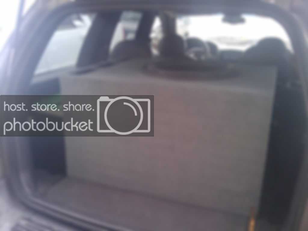

i know where the clocks at but dont know about the linking of radio and clock..hell wont ur new radio have clock?? heres pics of my stuff
[/img]
[/img]
[/img]
That's one big f*ckin' box. I do have a clock on my radio that I'll be putting in there, I'd just like to be able to keep the VIC (what that display is called) fully functional.
