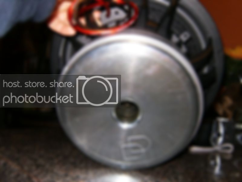

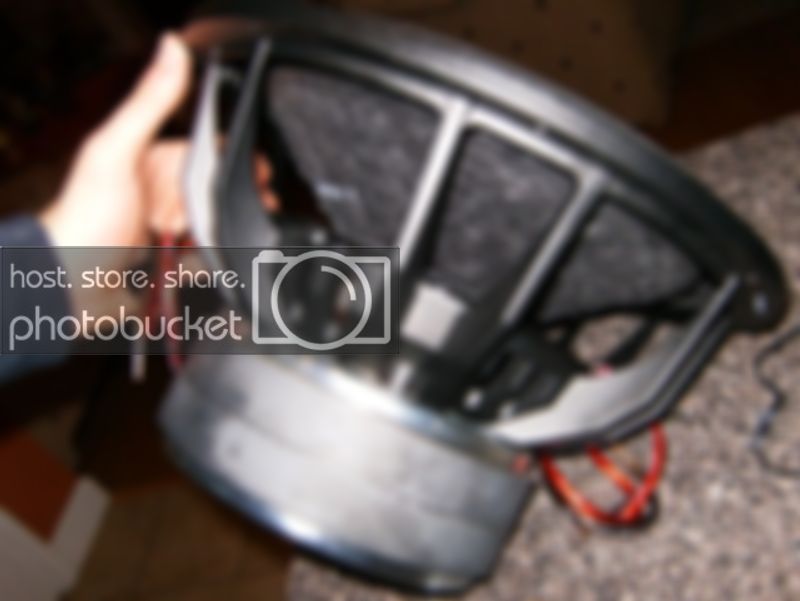

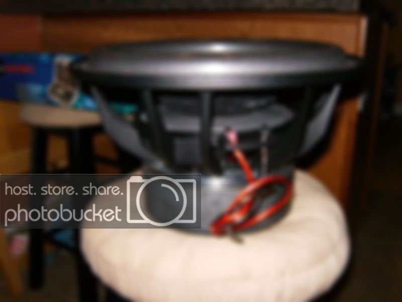

DD3512's, wondering what motor they are? Could someone identify them and possibly give box recommendations for them?

last i checked they were on e, and A, B, C, D, all precede E so I would assume that they made 1 of each //content.invisioncic.com/y282845/emoticons/smile.gif.1ebc41e1811405b213edfc4622c41e27.gif
Shared chamber .....3.5 cu ft.....for pair plus port...make port opening 56 sq inches....port length 19"....or two round 6" ports ...will work also //content.invisioncic.com/y282845/emoticons/smile.gif.1ebc41e1811405b213edfc4622c41e27.gif be sure to add port area to box specs //content.invisioncic.com/y282845/emoticons/wink.gif.608e3ea05f1a9f98611af0861652f8fb.gif
