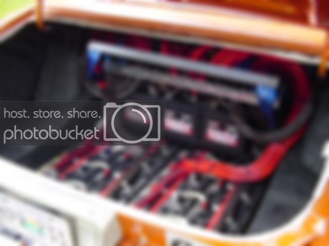

Here is a pic of the trunk right after wiring some batts

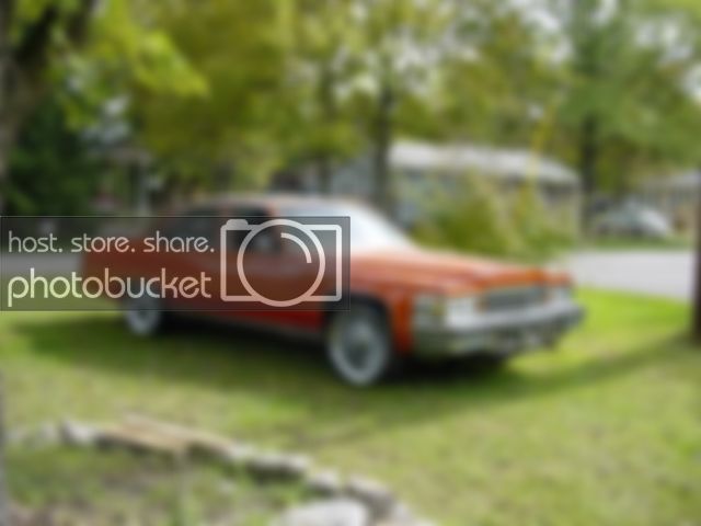

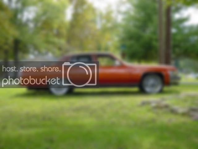

Wow....thats the first show I had that thing at. Carl Casper many years ago. It has changed alot since then. The box looks exactly the same but much prettier and better speakers.
The car has......
108 - 5.25's (I designed them and Concept built them) (Ported box tuned to 50hz' date=' thats as high as I could tune it with the port area I had to work with.)
36-American Bass VFL-150's (([b']130,00 watts[/b]//content.invisioncic.com/y282845/emoticons/eek.gif.771b7a90cf45cabdc554ff1121c21c4a.gif )) (First real amps I had in the car)(Most power too)
72-Memphis 1000D's (Second real amps I had in the car)

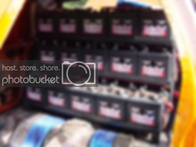

72- Turbo Start 8 volt batteries.
The car always metered sealed up on the dash. Highest I ever got it up to is 176 before the Concept speakers failed. That was on Linear X. which reads the same as the B&K. Atleast my Liner X did.
It sounded like a really pissed off fog horn!!! It was awesome. I really miss it. I may just bring it back out for the B&K Record. //content.invisioncic.com/y282845/emoticons/naughty.gif.94359f346c0f1259df8038d60b41863e.gif
That car made many a B&K competitor nervous. LOL.
I will find some updated pics and try and post.
