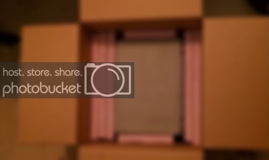

Ok I have heard many horror stories on how people have mispacked batteries and get all these questions on how I pack mine. well there are 2 ways to do it and both work amazing and out of over 300 batteries in 3 years of doing battery sales i have only had 2 get damaged and one was because it went out of country and the other was because the fedex lady, yes lady droped the 80 lbs battery off the truck right onto the corner.
Step 1.
Buy a box big enough for the battery and a good amount of packaging.
The sprinters i just shipped were 12x10x6.75 so i got a 14x14x14 box.
Step 2.
put about 1.5.3 inches of packaging on the bottom since this is where the most weight will be at all times. i used 3 pieces of 1" styrofoam 14"x14" each.
Step 3.
Put the Battery in the center and pack around it completly and make sure its tight fitting but not too tight to were it makes the box bulge out. I used 1" pieces on each small side and 3 1" pieces on the longer sides.
Step 4.
Put another 3-4" of packaging on the top of the battery. I did 4 1"x14"x14" pieces on top just because i figured during the holidays these things wil get stacked on top of each other to fit more crap on the truck. I actually could stand on top of the box it was so sturdy afterwards.
Step 5.
TAPE! TAPE! TAPE! tape the flaps. then cross over the box with the flaps and across the flaps. then tape the seam on the side of the box so it doesnt blow apart from getting throw around so much. Then do the bottom or other side the exact same way. Double layer tape AT LEAST! you can never use enough tape. Its inexspensive and a life saver from careless shipping workers.
Total cost of shipping supplies.
Boxes-$3.00 each
Tape- $2.50 a roll
Styrofoam- $6 per battery
so it cost about $10-15 per battery to ship it right and be worry free.
Heres a couple of the 7 batteries I shipped out this week.
