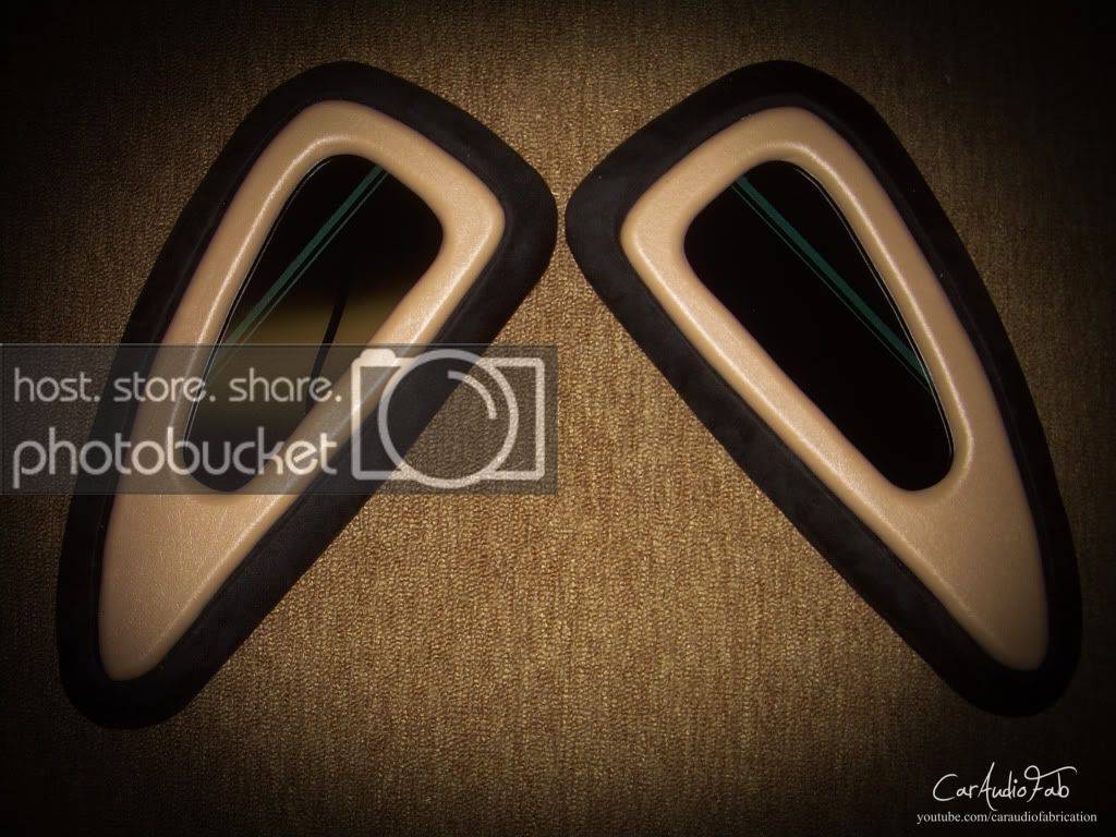

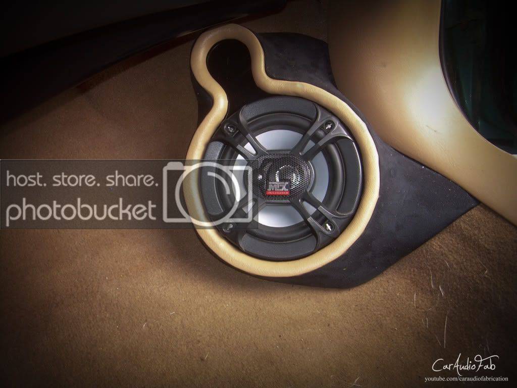

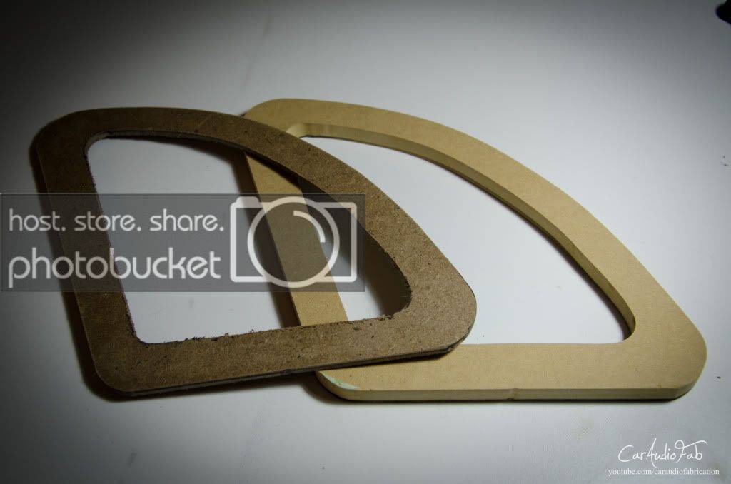

Hey guys! Have you ever seen panels in installs like this and wondered how in the world did they get those shapes?
Well with a series of router tips and tricks, you can start with literally any shape drawn on paper (shown on left), and transform it into a perfectly fabricated wooden template that you can then copy several times into future installs. (Shown on right).
Take your installs to the next level with these shaped panels that you can use for hiding amps and crossovers, trimming around speakers, making amazing port shapes, the possibilities are endless! Let's get down to the nitty gritty:

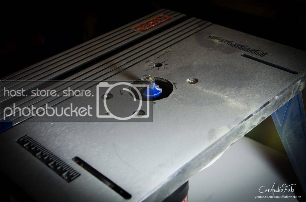

Router and Router Table:
Where to find:
Online, Big Box Hardware Stores
Starting Cost:
$100 (Don’t let the cost deter you, you can easily make this back doing installs for friends and family)
The workhorse of the operation the router and router table combo will allow you to use various “bits” to create different features that lead to the finalized template.
Important features to look for:
  • Variable Speed
  • Compatible with .5" and .25" shanks
  • Bit Height adjust from top of table

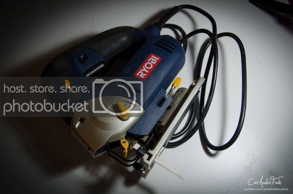

Jig Saw:
Where to find:
Starting Cost:
30
A more basic tool, there is probably not much info needed here. This will be used to rough cut your template shapes in order to minimize the work that your router must do to cut into the wood.

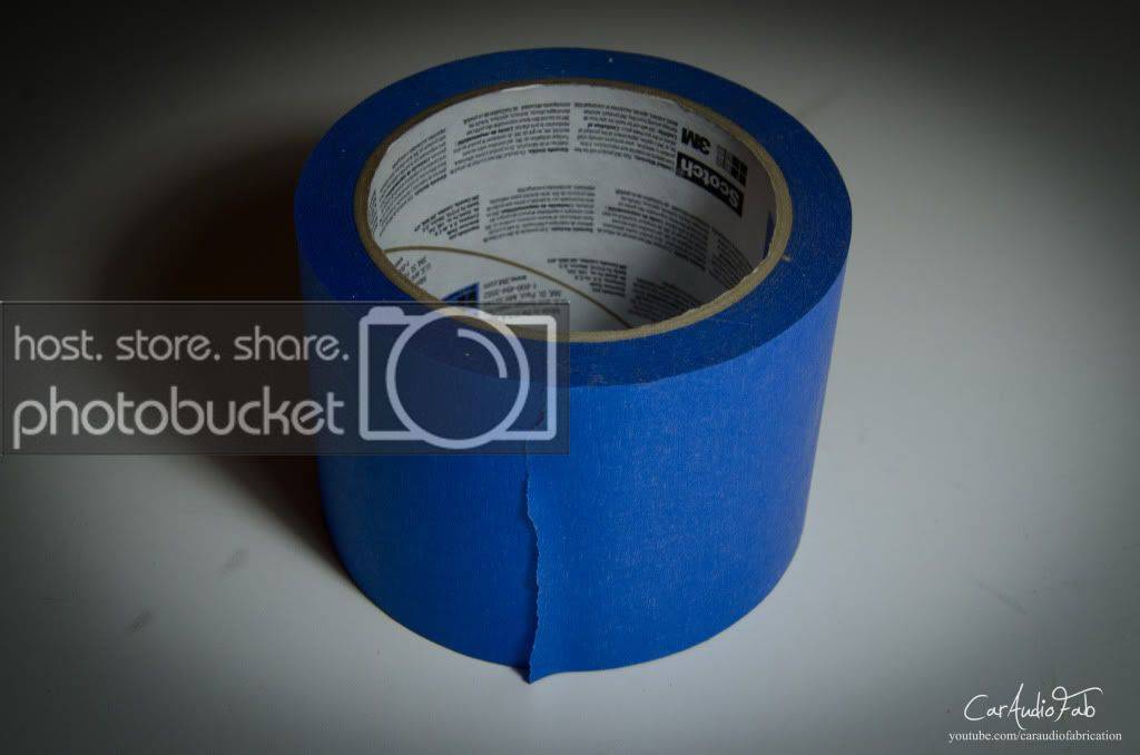

Painters tape:
Where to find:
Online, Big Box Hardware Stores, Art Supply
Starting Cost:
3
An easily found item, we will be using the painters tape to protect our panels on steps that require the use of body filler.
