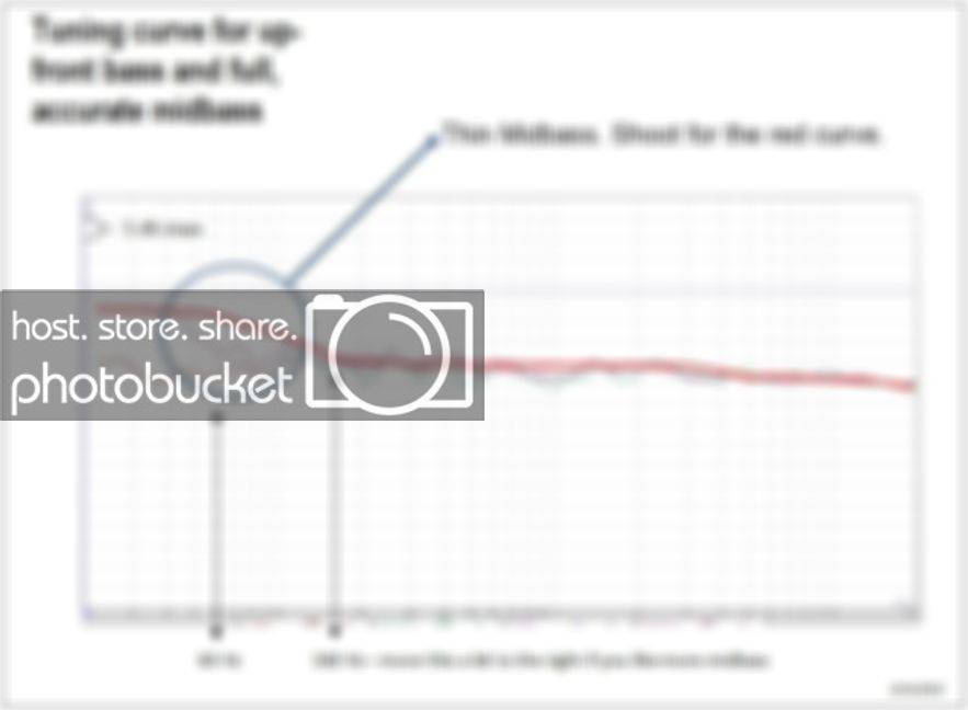

I think what your thought process may be heading toward is "How do people get the bass to sound like it's all up front?". You absolutely don't need to have a subwoofer up front to get bass to sound like it's coming from the dash. When people say they added a ton of delay and it "moved" the sub up to the dash it's because it changed the frequency response. The target response curve for up-front bass has a gentle slope coming down from 60 Hz and leveling off somewhere around 160-250 Hz.
You happen to have any pic or graphs to show what kind of slope? Gentle is kinda vague
