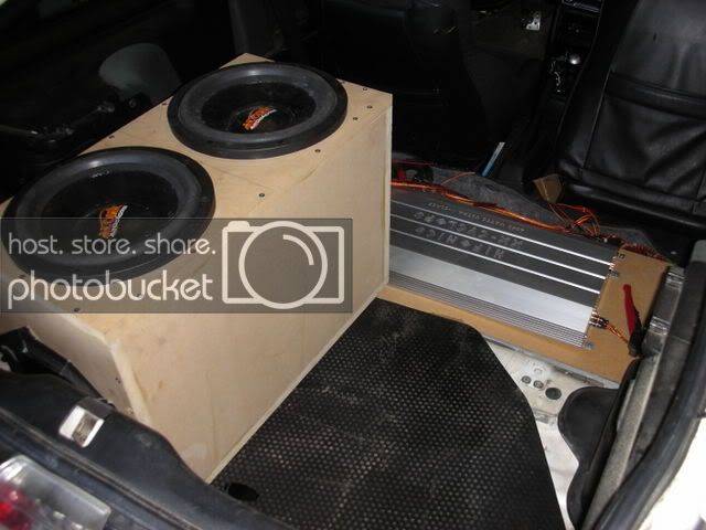

sorry but i don't have any SPL back ground, that's why i'm here.
OK with 4 drivers i have to fire them up.
but if i port out the back of the box the port will be right aginst the back of the hatch, and will be blocked.
so could i fire the port out the rear side of the box ?
and would it be louder on the driver or passenger side of the car ?

You can use the 10s you have now, or switch to the L5 or L7 10s. Since you dont have a ton of power I would suggest the L5s. Most people see better gains on them with lower power.
Another thing I would siggest if get 12" L5s instead of the 10" you are looking at.
Build your box sub up and port back.
2 choices...slot port of aero port. IMO Aeros in a CRX is best. I'd do somewhere ~1.2-1.7 cubes each. Run the aero ports (2 4" or 1 6" for each box) out of the box facing the rear.
Use this site to tune the lenth... www.psp-inc.com
Your car will be its loudest in the upper 50s to low 60s herts range. I would start your tuning at 50hz and work your way up.
CRX's arent hard to get loud...just build and test is what it takes. You may want to look into getting a mic to test with. That way you arent guessing...you know what numbers you are doing.

wow all the bad advice in here is killing me
for a crx i have had my best luck with 2 10s
subs up port back work just fine in a rex
did a 153 so im sure you will do just fine....
now im pretty sure u can build all the way to the b pillar and if thats true you should just build 2 1 cube boxes with a single six inch aero for each do the subs firing forward and port firing back and you could be loud //content.invisioncic.com/y282845/emoticons/smile.gif.1ebc41e1811405b213edfc4622c41e27.gif

Everyone that knows me on this forum knows I'm a big DD fan...but there is nothing wrong with your Kickers and having a crx with the amps and subs you have I'm pretty sure if set up for SPL you should easily exceed 150dbs....It will need to be ported though....A 150 will be extremly competitive at local shows....
everyone keeps saying fire the port back but if my box will fit tight aginst the back of the car there wont be any room between the port and the back of the car.
how much room will i need between the port and back of the car ?
and give me some idea of where to tune for spl and some listning
