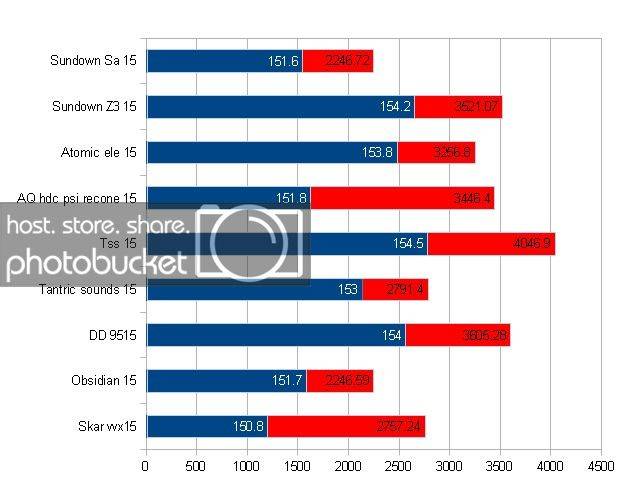

POWER and SCORE graph:
Notes: TSS actually did a 154.9 @ 48hz with 4410w
All tests were done around same temperature: 70-80'

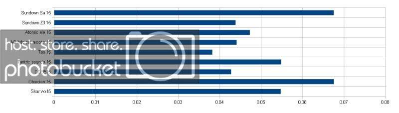

WATTs to SCORE ratio:

sorry if i missed it somwhere, what kind of vehicle and amp did these see? I might grab a SA-15 from Skar
2004 Explorer Sundown 3500 @ .5-1ohm depending on sub
Skip, I can't find the Obsidian video on you channel anywhere, been looking for a while. Could you kindly point me to a link? Also what meter and are these outlaw or sealed on the dash, kick, etc?
I didnt video all of them doing score sadly...just 2 too give a reference of what i did.
And it was all USACi style
