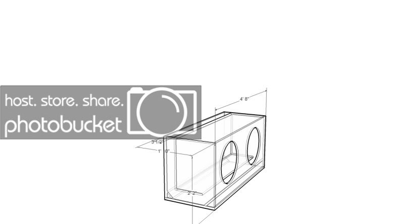

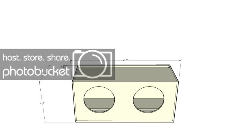

Ok guys I finally got everything in so Im having my box built early next week. Here is a Design below for my 2 18" Level 4 XL's:D. Its going in my 03 Gmc Sierra Ext. Cab taking the back seat out for this. Specs are 190 3/4 sqin port area tuned @ 33 hz and is 11.27cuft after displacements

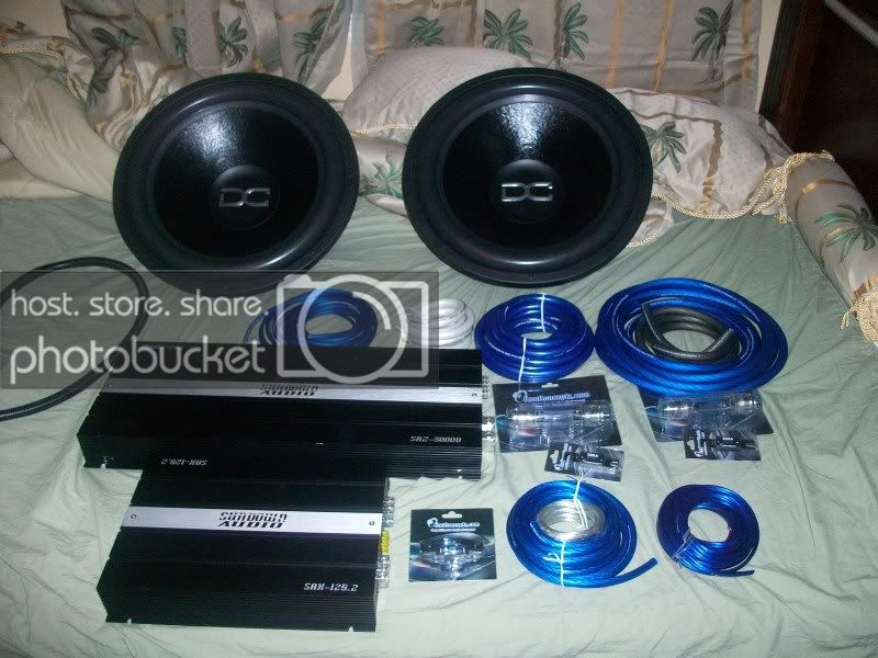

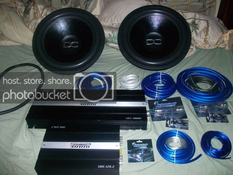

Everything thats going in the truck Plus 2 Large batteries and the MLA module which are not in the pictured
