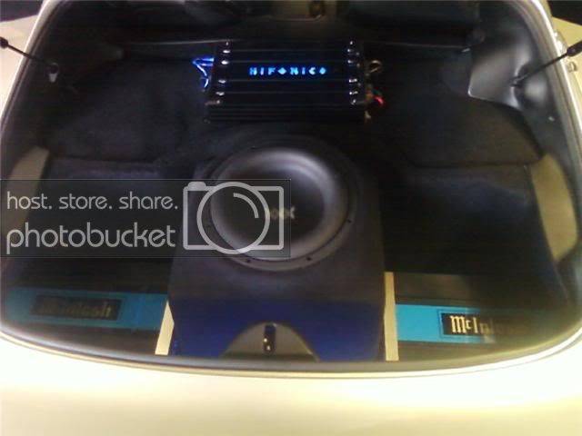

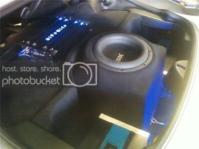

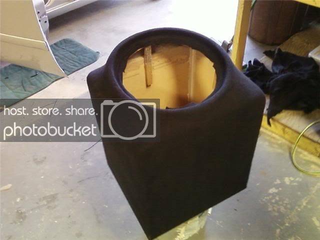

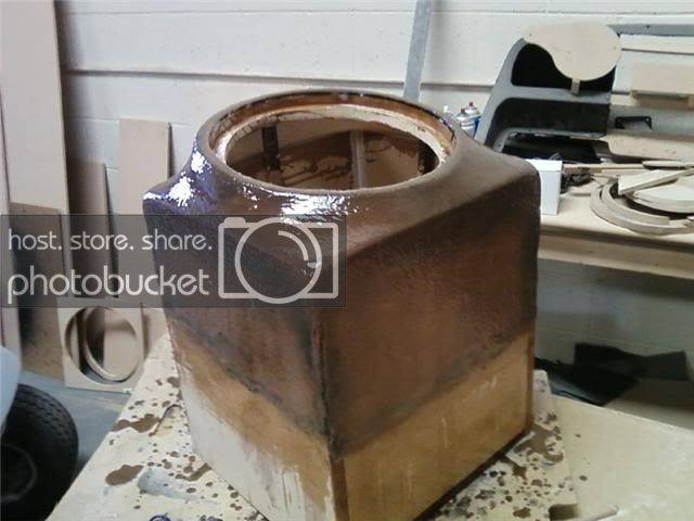

Don't know if this helps but here is the box the set-up...The top part doesn't have the cover so you can see everything better.
