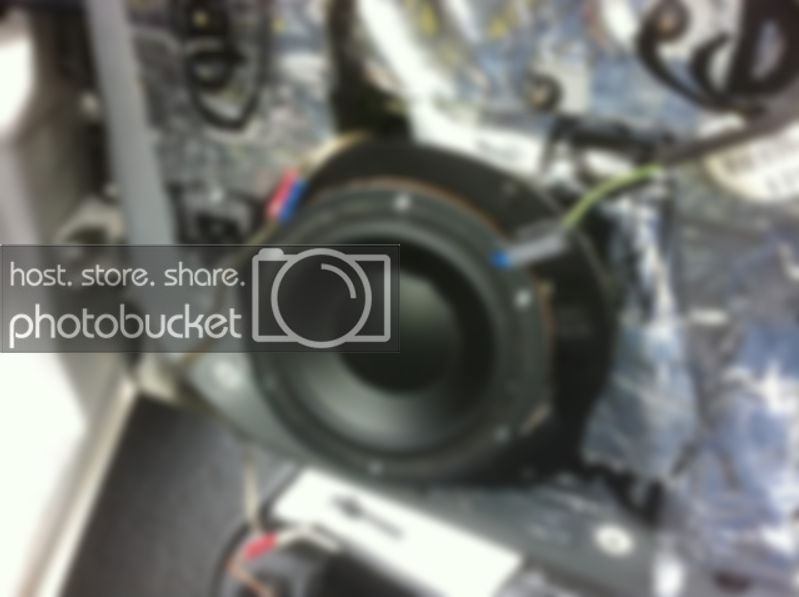

FYI - the doors in the bottom pic is in my accord. i'll be undoing all of that very shortly to accommodate larger/deeper drivers. that mounting is too restrictive (airflow from rear). i'll use MDF next time as well, but resin and FG and making a cone-type shape that gets smaller instead of larger, and also open up the door metal more.

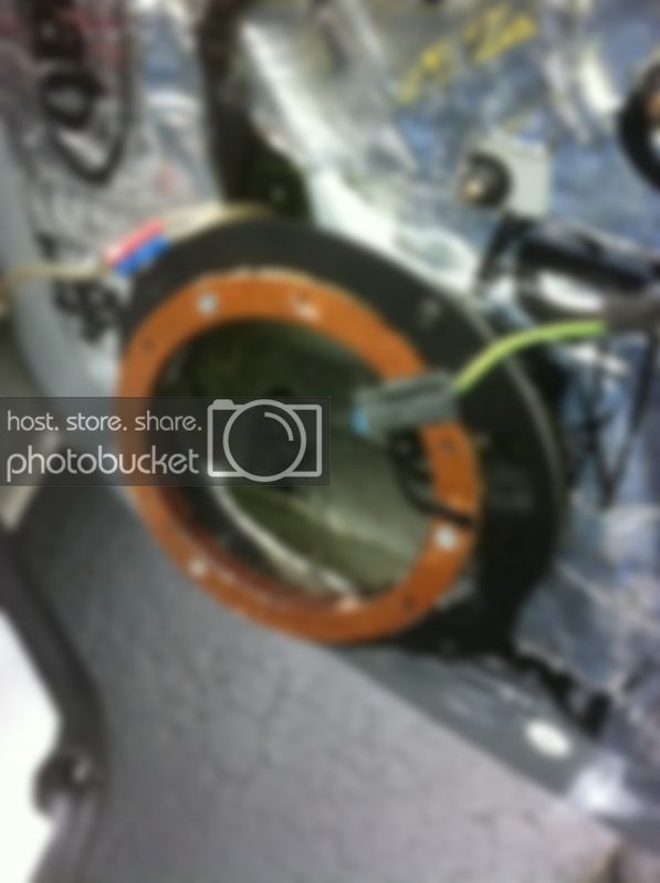

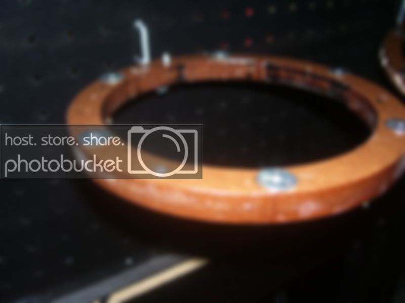

mdf can work, you just need to seal it and be careful what you do to it. i used t-nuts for the speaker for this set of rings and countersunk 3 holes for bolts to hold it to the door.
a couple layers of resin to seal it (this is after the first one only)
mounted to the door

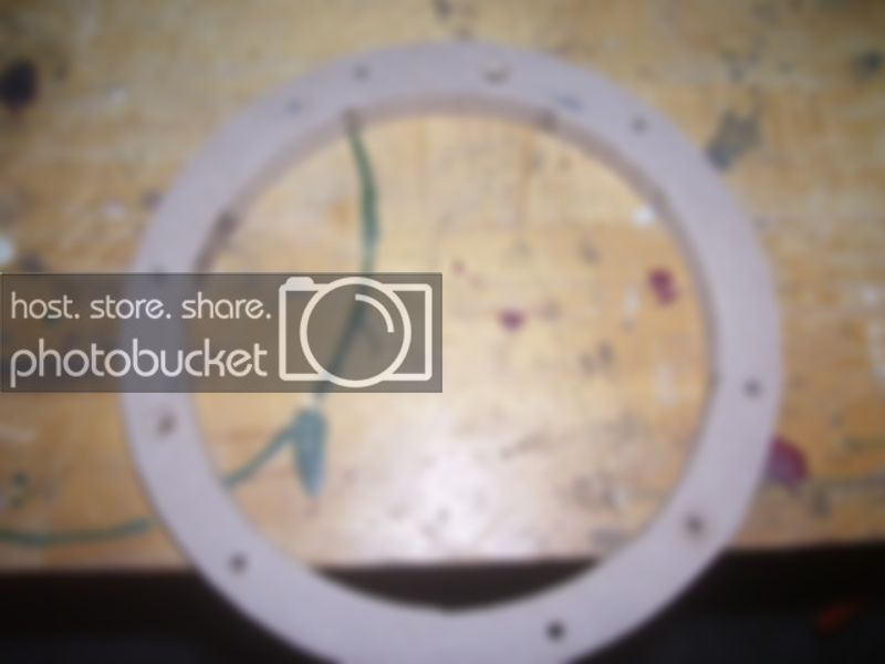

even easier than that is to just buy some cheap cutting boards at wal-mart and make your rings from that. they come in a variety of sizes but 1/2" or more for thickness and you are set. same procedure as wood - a few shallow passes with the router, just on a lower speed.
