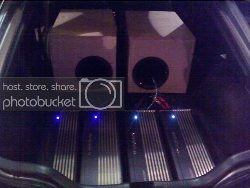

so I messed up a bit on the boxes, but nothing bad, lol... Home Depot had a fairly intelligent wood cutter so things are OK. I may need to hit them up for a belt sander or some more Ryobi mouse pad sanding thingies. Got one amp in at first, and decided on my lunch to add a second. Strapping two SoundStream Rubi 2500d's @ 1 ohm total - mmm. With one amp they barely moved at all, it was a very buzzy box though, which is my purpose. I have a daily banger box that is fantastic that I will put back in after.... pix in a few.

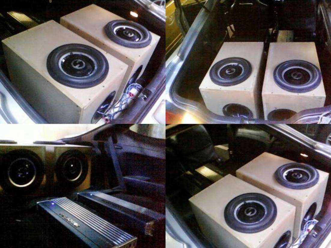

i believe my boxes will be in the spot that the amps are in now, i want all 4 amps across the back of my hatch floor... two looked cool so four should be even better. It's Pro No Wall no matter how I look at it in NESPL, so may as well cram them as far forward as possible. Have 13.5" and 9.5" six inch aeroports to play with, going to try internal and external in the upcoming days before the big show in Sanford.
wasnt all that impressed with my first round of testing. right around the same number that three did with two amps @ .67, lots to learn as always.
have boxes firing subs fwd subs up port external rear, shortened them 4" too
