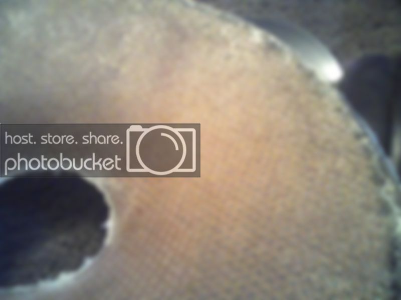

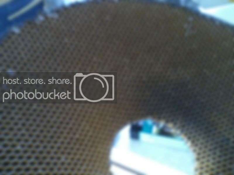

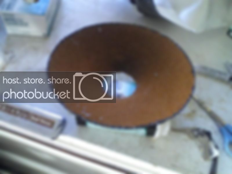

ok... so i peeled the nomex layer that was all messed up off the cone to expose the bare honey come...

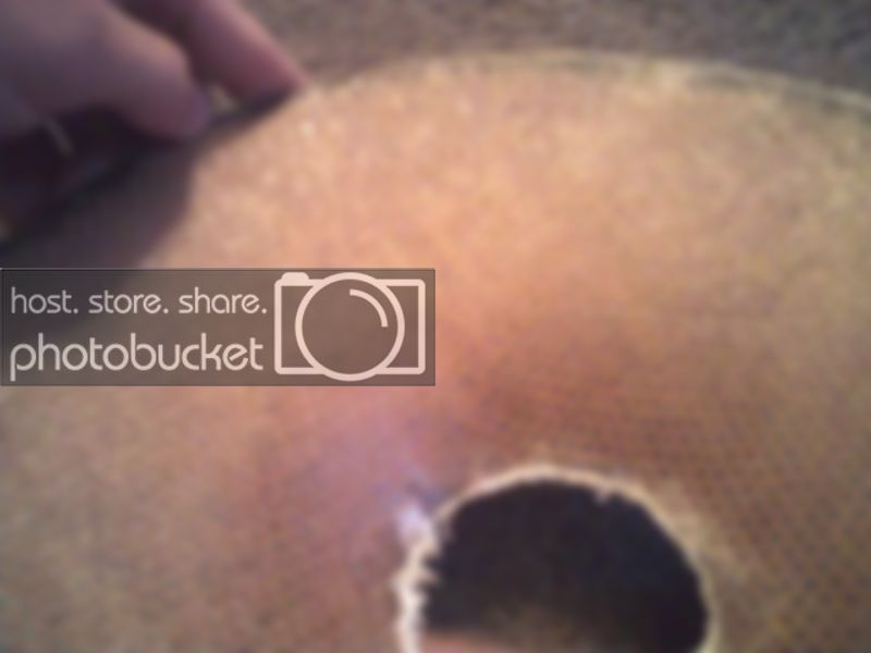

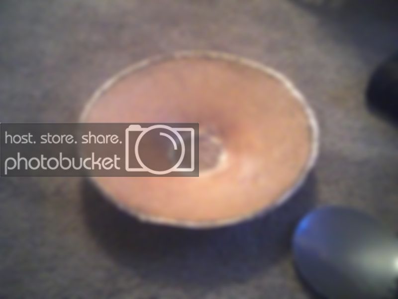

then i layed some fiberglass cloth on top of the honeycome and carfully aplied resin... i tried to make everything as even as possible...
i didnt get any pics of this

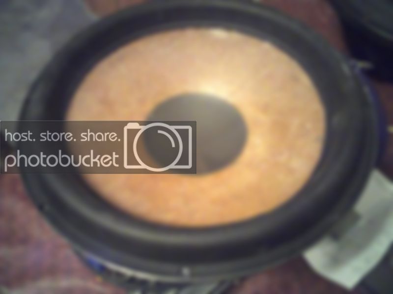

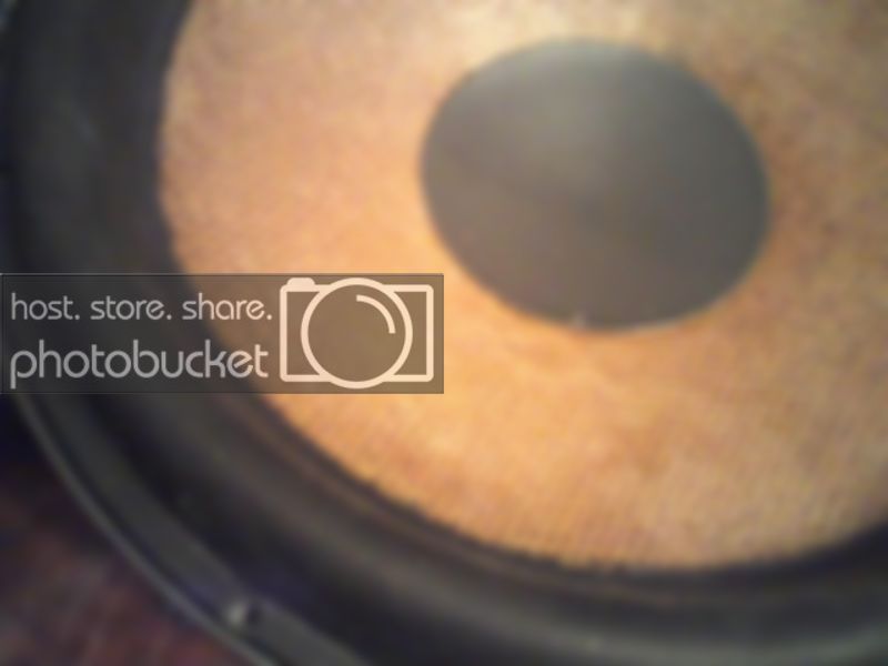

once everything dried i did a little triming

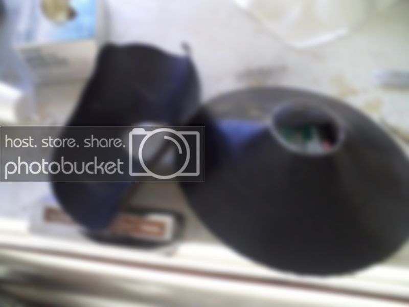

keep in mind i still trimed everything up nice before i put the surround on
i just put i tiny bit of glue on the surround to hold it to the cone, that way i can pull it off if i decide to paint the cone
now, thats just what i decided to do with a jacked up cone, im not sure if i want to use it or not since ive got a different cone one the way, im also not sure if i want to paint this cone or not, i have some real nice dark pearl blue i think would go on it nicely, but im not for sure
what do you guys think??? //content.invisioncic.com/y282845/emoticons/confused.gif.e820e0216602db4765798ac39d28caa9.gif
