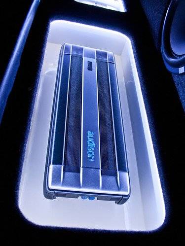

This is an amp rack/ cross over rack i did on a Lexus recently. It was the first "shown" amp rack i did and for me, it was pain in the *** with the measurements. Using cardboard to measure how the false floor would sit in the trunk, raising the trunk floor, going back and forth to trim off a little extra off pieces to make them sit flush. The amp sits on top of a polished aluminum bar, with a 120mm fan exhausting hot air underneath it, and 3 92mm fans blowing air on the amp (not viewable at the angle i took the picture). The amp appears to be floating when looking at it from any angle unless you get down low enough to see it sitting on top of the aluminum.
