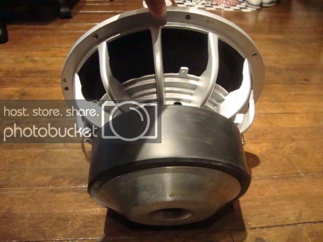

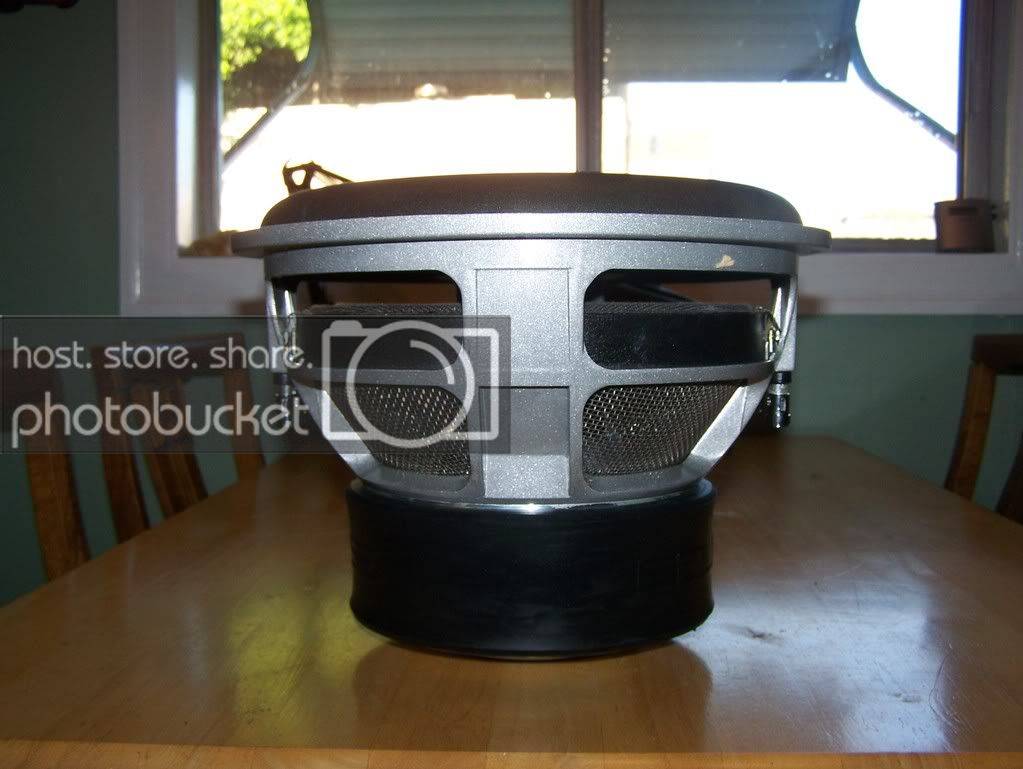

pic i found
1st pic to me looks like a 3hp and the 2nd one looks like the Tc9 lol
The motor looks kinda small for a 3hp. It'll be easier to tell w/ the boot off. IIRC, tc9 have no more than 2 slugs, either .75" or 1" slugs
It's very simple. The aluminum cone drivers have a TC9 motor, the titanium cone drivers have a 3HP. The only difference between the 8 and 9 series titanium is the QCA. The 8 series titanium does not allow for removal of the top assembly, the 9 series does.

see thats what i thought.

SO SIMPLE INDEED!
For real though I'll take your word on that. I've been lied to by more than 1 person about those motors I guess....
I can tell you right now looking at that back plate it's a 3hp. Notice how it's a lot more rounded off than a tc9.
