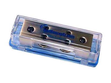

Thanks for all the suggestions. I found one that acually do really good here. I Would use 2, but I can use KnuKonceptz 1/0 Kolossus (Actually 2/0 gauge AWG, capable of 300 Amps X 2, because I would run 2 of them) to the 2 distros, and then their 4 gauge Kolossus (which is acually 3 AWG, and can handle up to 120 amps, perfect for one 12.1)
Sumthin like this:
The Tsunami block shown on eD is only a three output. 1/0 on the ends and three holes in the middle for 4 gauge. The "holes" for the 4 gauge are probably open on both sides of the block so it can be mounted any direction. Fitting two 4 gauge cables into a single 4 gauge opening is not something I would want to try.
This block below is no longer offered by KnuKonceptz as it has been replaced by the one linked:
It is similar to the Tsunami, but with four 4 gauge blocks
