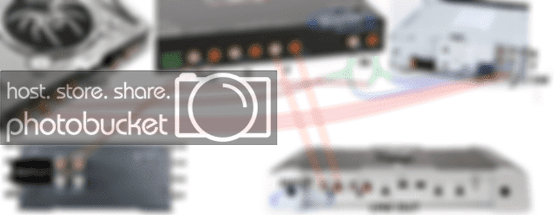

need some help....have a look at my rca?? will post 2 pics both of booty shots and see if i hooked it up correct, if i didnt the 2nd pic is blank so you can draw out the rca.....first time using 2 amps, eq, and epicenter so i dont know how to connect it all....THANKS!!!!

no it is wrong
You cannot run the sub out from the headunit and get both front and sub out of that.
I would run from the headunit sub out to the bass cube (or what ever that is called) then from the bass cube to the sub amp by passing the crossover
Then run the front out of the headunit into the crossover then to the front amp
BTW what is the purpose of the external crossover if your headunit already has front and sub outputs?
no it is wrongYou cannot run the sub out from the headunit and get both front and sub out of that.
thats what i was thinking but i thought he was going to use the front outs on the h/u my bad
the eq? i want to able to adjust it without having to go thru the setting in the HU
here is how I think you should do it
Front Output from head unit to EQ
Output from EQ to front amp
Subwoofer output from head unit to Epicenter
Epicenter output to the Sub Amp
I do not think you should run your subwoofer output through both the EQ and Epicenter, that could really over process the sub signal and would lead to distortion
