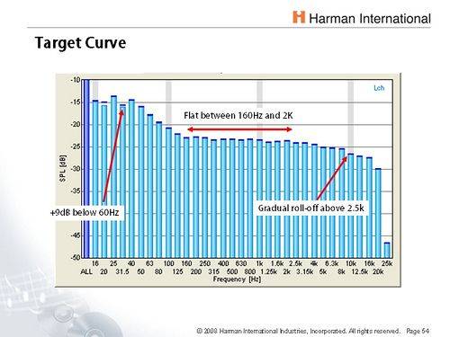

First and foremost... how does it sound? RTA is a great tool, but it can't tell you what it "sounds" like.
Second... are *trying* to get it perfectly flat? If so... why?
Just looking at the RTA (and assuming that free app one isn't totally useless), I imagine your midrange is overpowering and top end is crazy hot.
I've done mine flat and I thought it sounded like ass. But that's my opinion. If you like the way it sounds right there, then that's how you should run it. But you should try out some other curves to see if you like them better.
This is just one example. But it's a good one (and a popular one). This is the JBL "target curve". You can see how it's fat on the bottom end instead of the top (like yours). Some say +4-5db, others might like +8-9db on the bottom and sloping down to flat ~ 160hz. The other thing is... you see how it rolls off over 2.5khz? If you are flat past that, chances are that your tweets are loud as shit.
