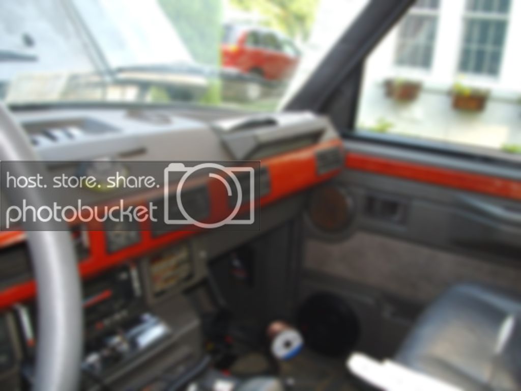

Here is the inner door panel that the speaker is mounted to, the tweeter is behind in the smaller upper speaker grill.

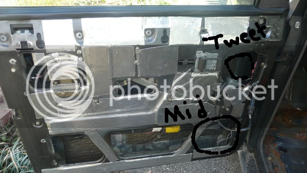

Here is the inner door, I have circled the part where the speaker sits. BEFORE YOU FLAME> This pic is from a while ago and much more damplifier has been added as well as the two layers of overkill. I have the overkill covering the big gaps in the door as well.

If your good at fiberglassing(which I'm not) then go that route. If not you could always cement your doors //content.invisioncic.com/y282845/emoticons/biggrin.gif.d71a5d36fcbab170f2364c9f2e3946cb.gif lol
Use MDF to mount the speakers to the doors, but if you haven't, you're going to have to seal up all of the holes. Pick up another set of speaker grills, and leave the grills in the door panel, but the speaker itself mounted to the door. That would be the cheapest route to go before fiberglass.
