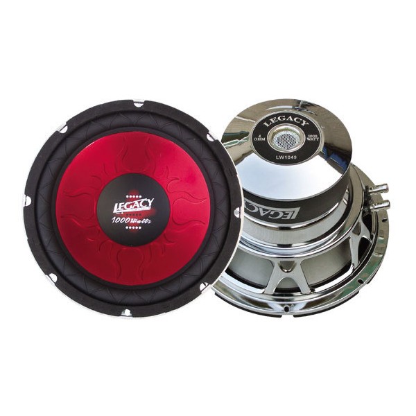

I bought myself two legacy 15" subwoofers (pants i know)
They are 750w rms each (supposedly:laugh: ) and i am unsure as what amp i should be looking for to power theese 2. Any help on what i should be looking for etc.
they are 4ohm independance and have dual 2.5" high voice coils if this helps.

fs- 21.2
Qma- 5.0
Qes- .90
Qts- .75
SPL- 84
Vas- 5.204
Woofer is more suited for sealed applications.
Calculator shows a box size of 3.336 ft3 with a Qtc of 1.2, this per woofer so the total enclosure size of 6.67 ft3.
RMS power handling of the woofer is no more than 400 watts RMS per woofer.
thanx for the help buddy. What would you reccomend, to run at 1ohm or 4 ohm.
Also is there a diff in power between the two
With the amp i suggested run all coils parralel for a 1ohm load.
As for the question-(short non technical version)
At 4 ohms that amp will put out 500 watts RMS
at 1ohm it will put out 900 watts RMS.
