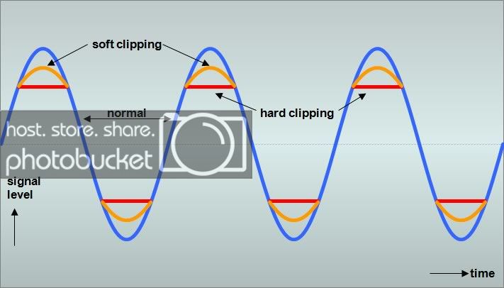

clipping is not "square waves" lol. clipping is when the tops and the bottoms of the sound wave is cut off. causing the sub to not be moving for a microsecond, and therefore not cooling for that section of the wave
like this:
Partially true. Hard clipping is actually a pretty good approximation of a square wave, but usually someone with even a shred of common sense has turned things down before it gets to that point because the sound has gone to hell and back. The sub does NOT stop moving UNLESS it hits a mechanical limit or the power applied at the peak can no longer generate enough force for the motor to overcome the surround and spider forces attempting to pull the cone back to the rest position. This usually isn't the case. Mild clipping isn't usually much of an issue in reality. The increase in average power is not tremendous until you start getting into heavy clipping where there is more time spent at max voltage/amperage than not.
good post. People need to realize that the since wave does not actually show the position of the speaker. The sine wave is showing you what the voltage coming from the amp is doing. Basically an amp can only put out so much power. Clipping means that you are attempting to exceed this limit. Since the peaks can't exceed a certain amount of voltage, when you keep turning it up, the parts just below that peak, becomes peaks as well since they CAN still be boosted. This increases the average power to to the speaker over time since the speaker is recieving alot more overall power. It has nothing to do with a coil not moving, as long as a singal is being applied the coil will be moving back and forth. Only time it wouldnt' as Helotaxi said is if you put so much power to it that it hits it's limits, then it'll bottom out.
