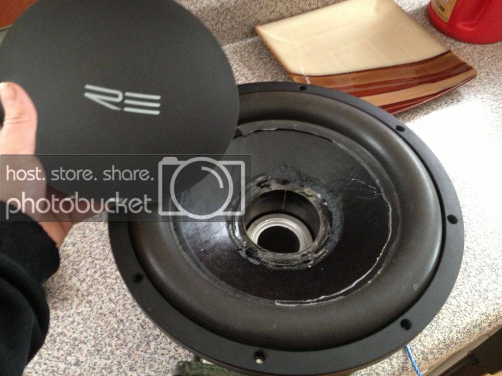

well you prolly have weak solder skills, hook the dmm up it and check it compared to other side. youll know when you have a good connection. My issues was not getting a good contact from tinsel to solder. Thats when i did this, pulled cone and added a whole new tinsel. i have had zero issues with it since. i have though had an issue with a tinsel i have never touch. but what can i expect out an 05 sub.
taking cone off
repaired left tinsel lead, right is orignial
