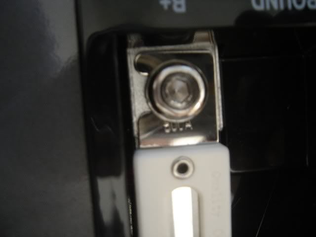

it only draws 350 amps of current
his other amp(Rockford T4000.1) has a 500A fuse??? and its a lower line RF amp(compared to the t15k)
his other amp has a 500A fuse??? and its a lower line RF amp(compared to the t15k)
