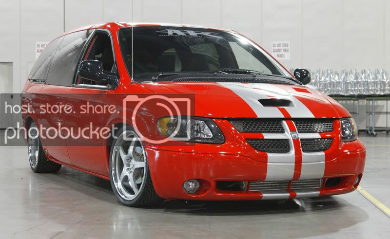

Air ride and 22's on a caravan?

The front should be a McPherson / super strut front end setup and shouldn't be hard to bag.
The rears of those things I believe run some kinda of I-beam or solid axle design (without the axle) which might be hard to design around, a IFS system may be easier to adapt.

air ride for that van is gonna cost a little more than that. Custom built front strut bags are gonna cost $1500 alone. The rear has a solid axle going across which souldnt be hard to get low if you can find some springs for it, i beleive the leafs in the back are a one peice composite design. I guess you could 4 link it but then you are going to have to more or less back half it because it doesnt have a frame. Its a unibody. And I doubt even then you could lay it on 20's without major work to say the least.

what kind of "major work" do you mean to lay w/ 20's
i dont even need to lay 100%
like .5"-1.5" off is finbe as long as i got big scrape block to spark
will i need to bring nething up like exhaust or gastank? oil pan?
