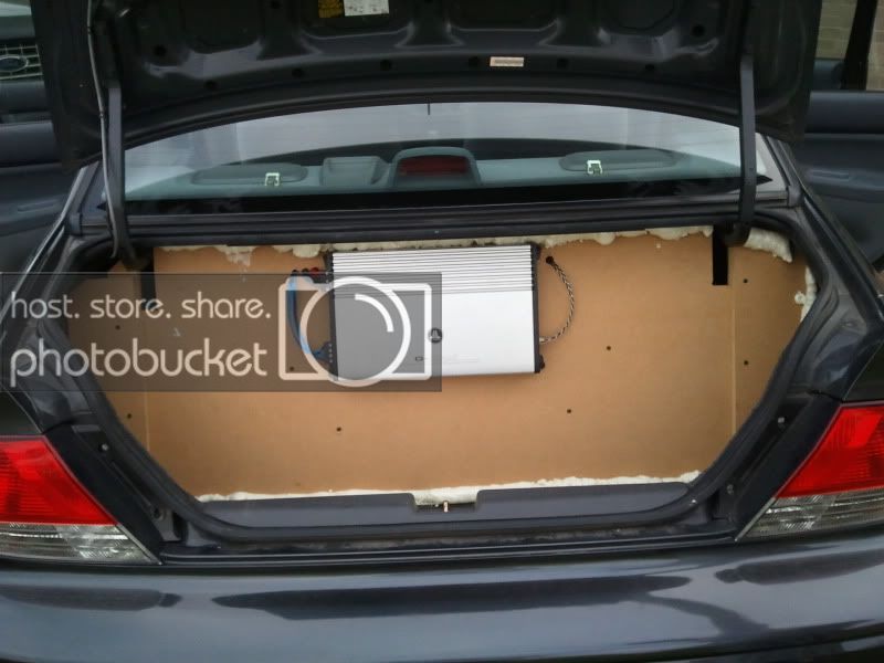

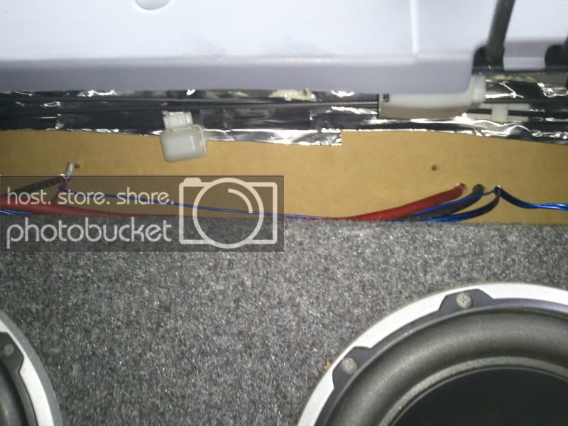

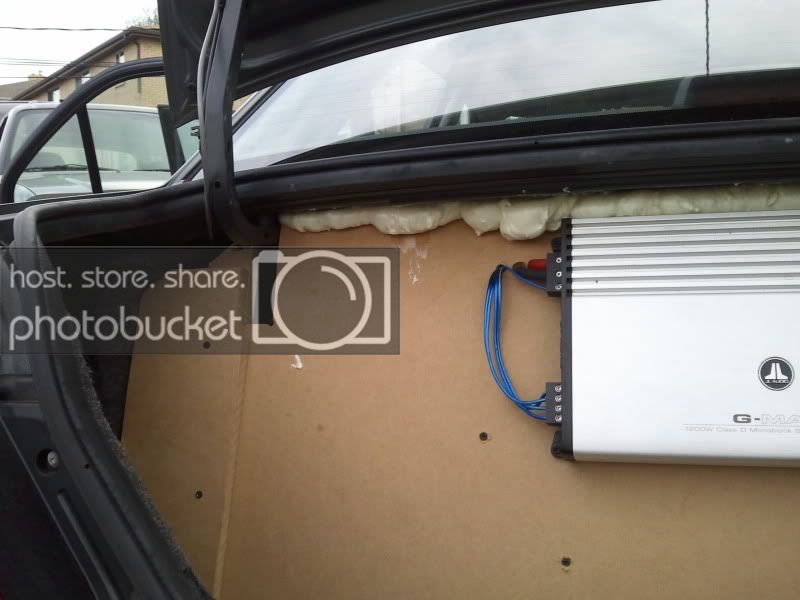

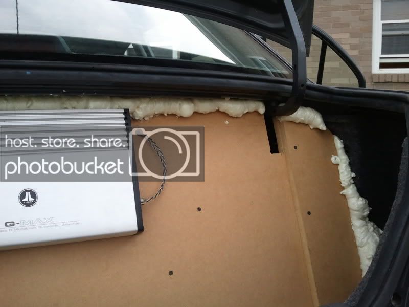

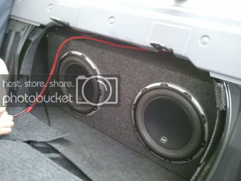

So I tried to help a friend out with his lancer.
2 jl 10" w6 / 1200watt gmax, in sealed box facing truck = sounds decent but trunk rattles like crazy
deadend the truck, put a wall up and faced subs into cab = sounds tighter/louder/better? NO!
ends up sounding worse and kinda dead. seems like sp is still escaping the trunk:(
I'm thinking the box needs to be all the way up to the seats and truck sealed tighter
what the hell did I do wrong? thanks in advance.
Also feel free to flame my hack job but please give some advice. I've never done a sealed trunk like this before
Filled this gap up with foam
Sleaze seal off the box bro. There could be stuck air on the sides. Idk just guessing.
There could be a million things wrong. Maybe it was wired wrong at the amp, box space is to small/big and just makes things more noticeable facing the cabin, the back wave is being reduced, etc.
Positive the sub should be sub back. If it wasnt it would have got better not worse.
We all know it sounded better sub back as the op stated. It does not mean its the answer to his problem
op- You can try sealing off the trunk at the baffle when firing into the cabin. The wall thing is a waste. Its not even really sealed off due to the trunk arms. Id try a different enclosure in general
im not expert on this since i own an suv, but from what ive seen most setups that do a wall are because the box is so big it ideally needs to be pointed frontwards. without sealing off the sides of your box you're doing like a half wall kinda thing, I think that may be your problem. pulling the subs forward a bit might help too.
Im gonna move it all the way up and tighten it up like frogs azz. If that.doesnt work then I might try some type of new encloser with a blow through into the arm rest.
If all that fails then idk. Deaden the rest of the trunk and re fire at the back //content.invisioncic.com/y282845/emoticons/crap.gif.7f4dd41e3e9b23fbd170a1ee6f65cecc.gif
