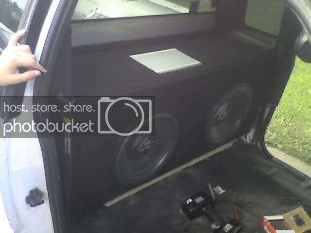

A friend asked me to throw something together...this is what came from 1 sheet of 4x8 3/4 mdf, 2 cheap rolls of walmart black carpet, 2 15" MA Audio EHO 15s, and a MMATS 1400.05(just one for the next two weeks).
Sorry no build pics....the camera was dead so a phone pic is all I could get
This is all wired up and ready to go. Stupid amp rack was a pita...reasons why you measure twice cut once...Anyway came out ok I guess...
For those who want to know..the box is 8ft3 after displacement and tuned to 37ish.
hah nice ranger lol.... isnt that back hump a PITA!
That is a 2000 S10 the ****** tunnel pretty much goes away right before were the box is...I did forgot about the **** step down when i built the box...lol When ever we add the batteries and 2nd amp I will clean it up a little.
Thanks for the kind words though. He likes it a lot, I think I could have done a bit better..but with in the time we had it just had to do.
Its around 51.5 x 16.5 x 18.5 with a 2.75 x 51.5 port 13" long
Those are all internal by the way
Oh, I guess I should say we did use some scrap wood I had laying around to finish the box. 1 sheet came up just a bit shy.
