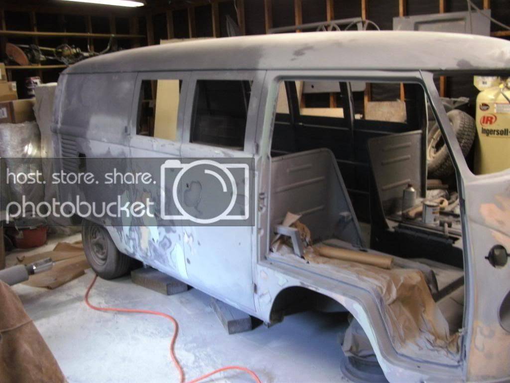

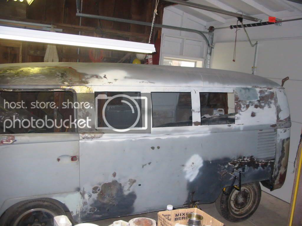

The bus close to when I got it and started the resto:
I installed New rear quarter panels, rear corners, sections of the floor, nose, roof and other misc parts of the bus were replaced.
I had the Porsche 944 brakes modified to fit my '65 VW bus.
I designed and built a 2270cc Type 4 engine for the bus. Using a '74 "superbeetle" IRS transmission temporarily.
I sectioned an IRS rear end from a '69 bus into my bus.
It has airbag suspension in the back for now. I need to save money to finish the front.

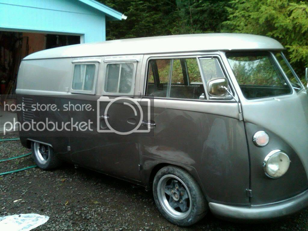

Here's what it looks like now:
4 Years of cutting, welding, sanding, priming, etc finally paid off. //content.invisioncic.com/y282845/emoticons/biggrin.gif.d71a5d36fcbab170f2364c9f2e3946cb.gif

nice resto...but It needs some nicer wheels...does it have the 2.0 in it ?
I wish I could put some different wheels on it but the Cookie Cutter (Porsche 944) wheels aren't very common. Having the 5x130 pattern makes it hard for wheel choices and I don't have the money for custom made wheels. It has a 2270cc (96 x 78.4mm) engine I designed and built based on a 1.8L vw bus case (same as 914).
