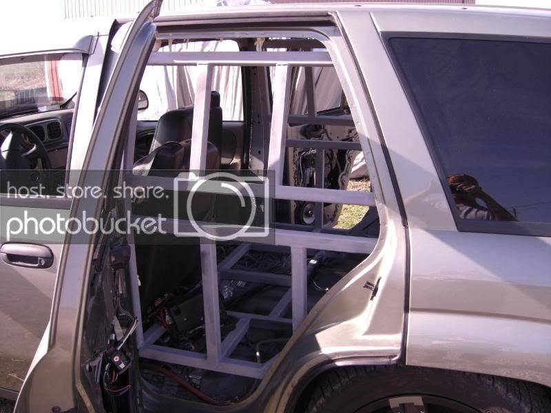

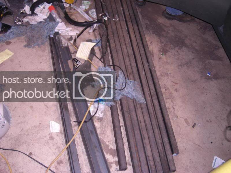

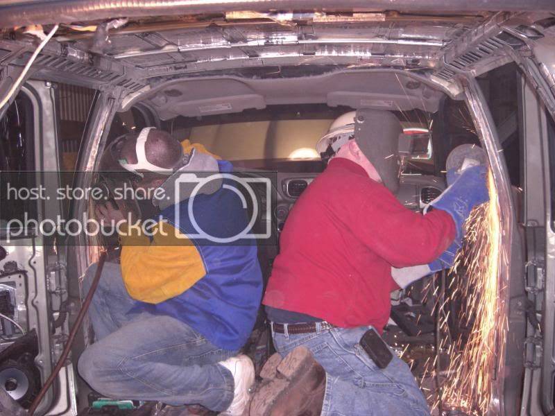

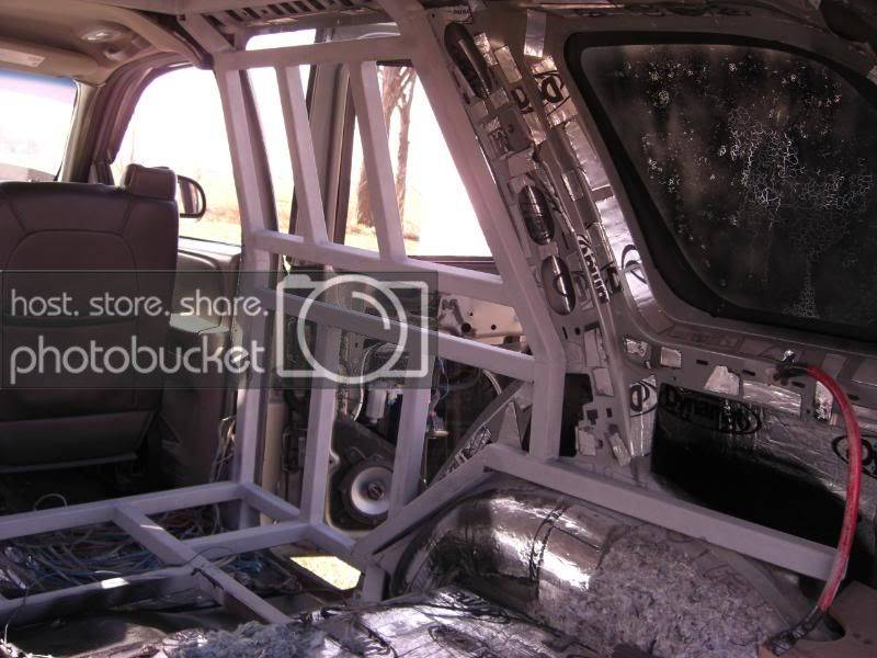

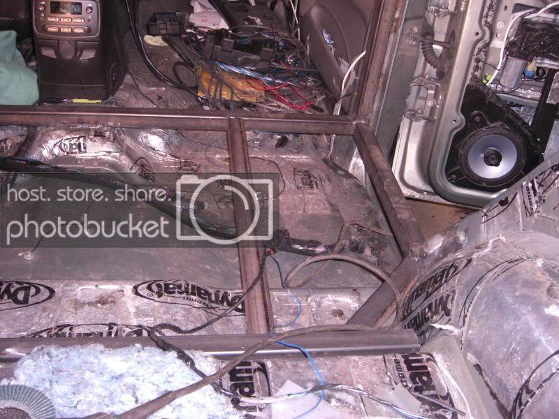

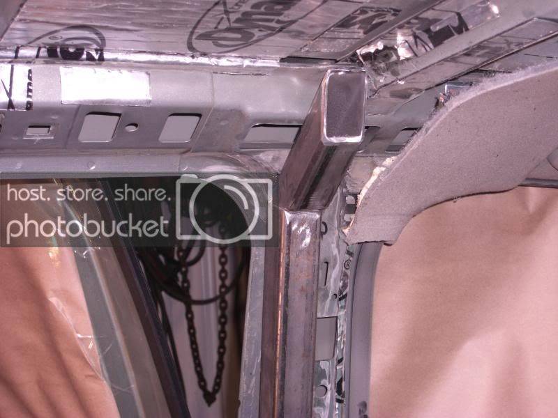

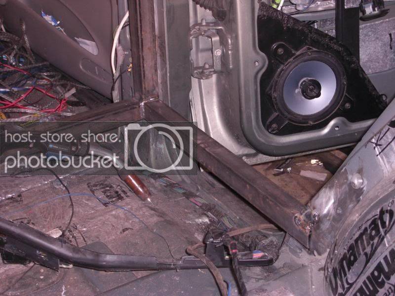

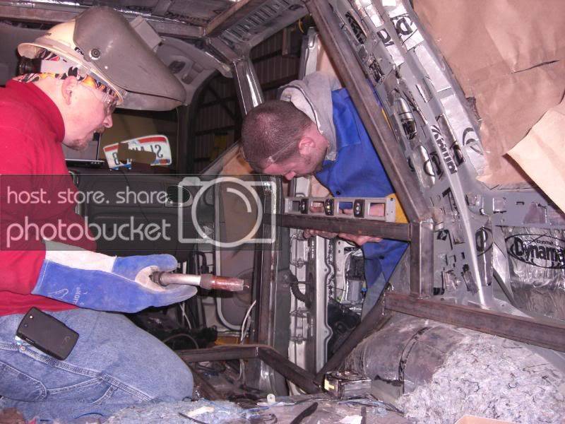

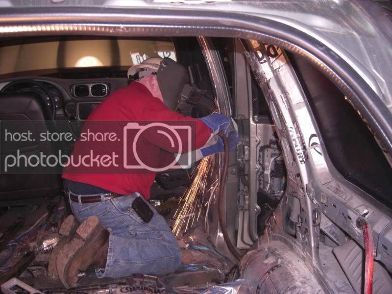

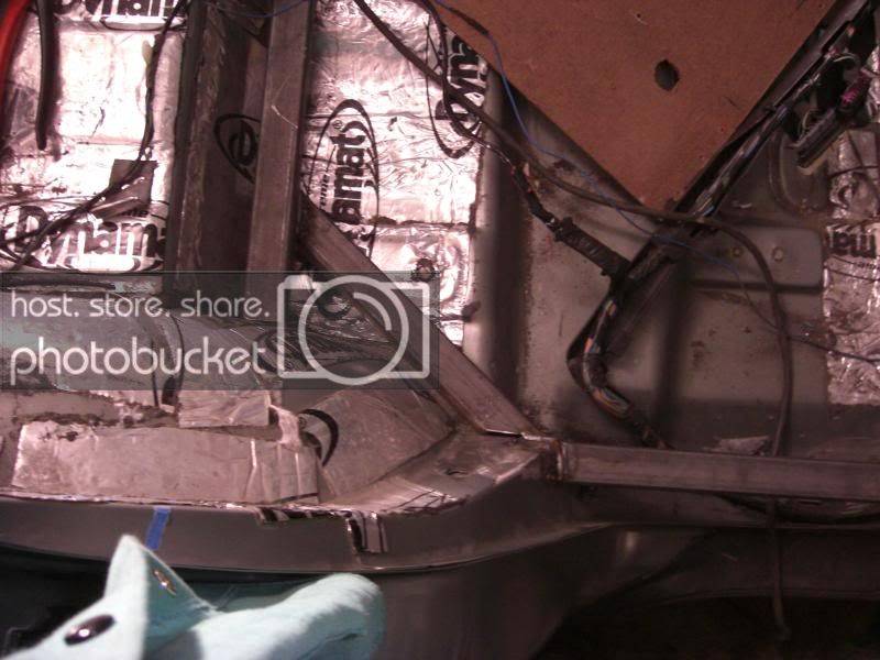

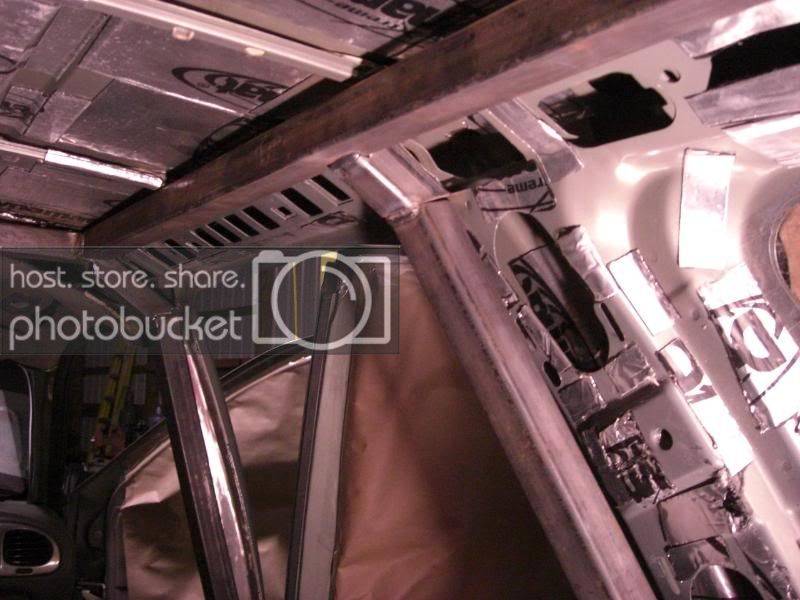

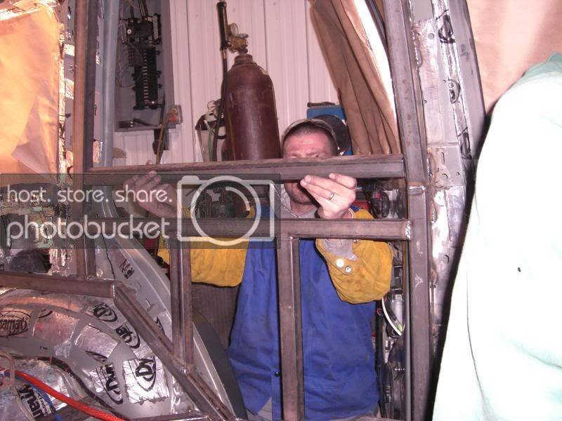

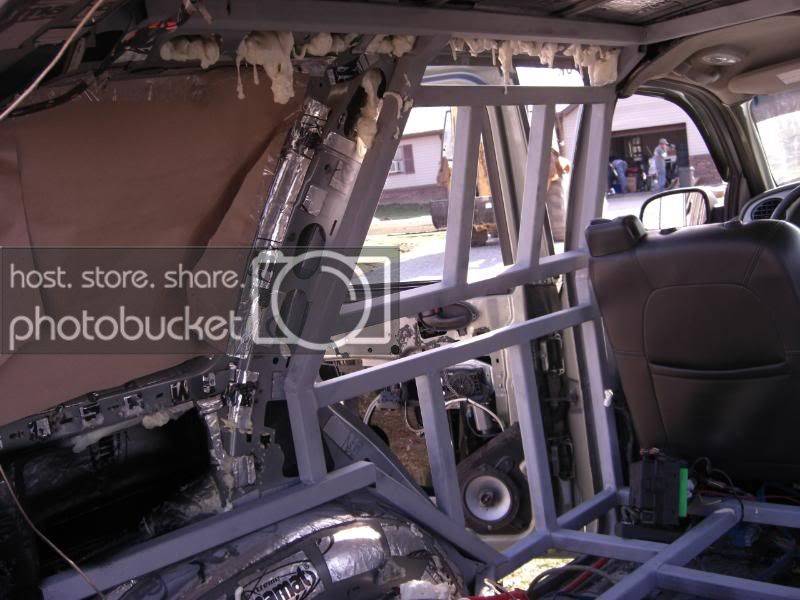

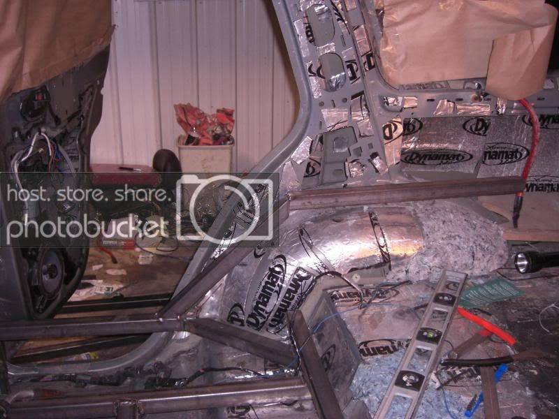

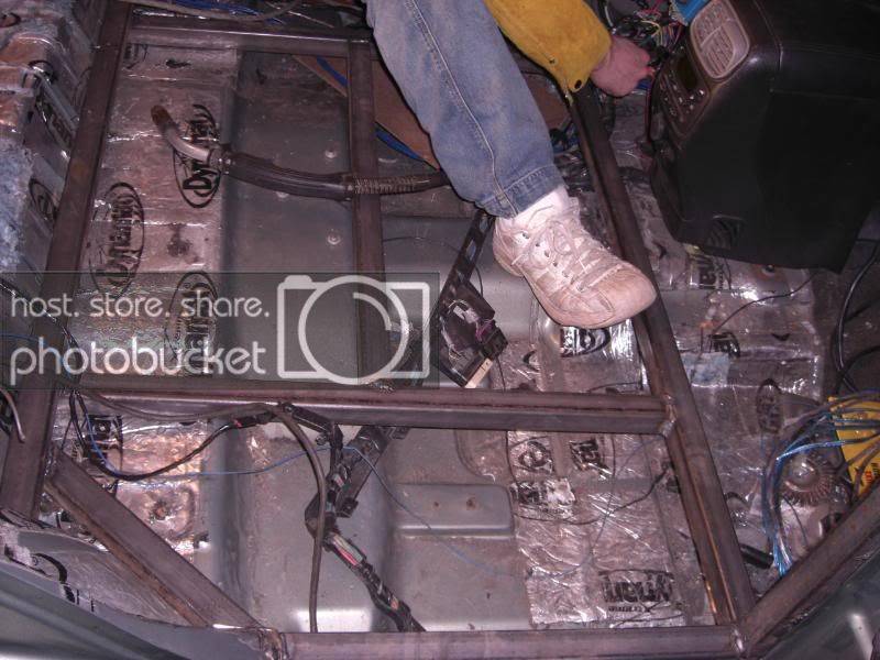

I started by tearing out the whole rear of the TB including carpet... Here is what I started with. 72' of 1.5" X 1.5" X .250" Box tubing... Total of over 200' used...

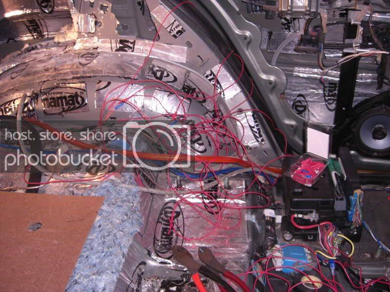

I had to extend the BCM wires and relocate it...

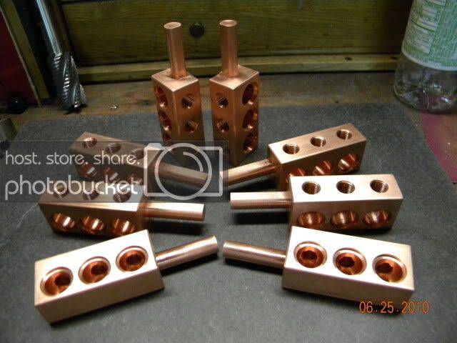

Had to get some copper stuff made (Special Thanks to TOOLMAKER on CACO)

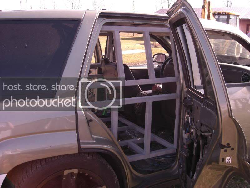

How did you paint the tubing with it inside the car?
I can't wait to see a video of this
With etch primer, then regular primer, why? Im not afraid to get paint on the truck since its getting shaved and repainted anyways...
