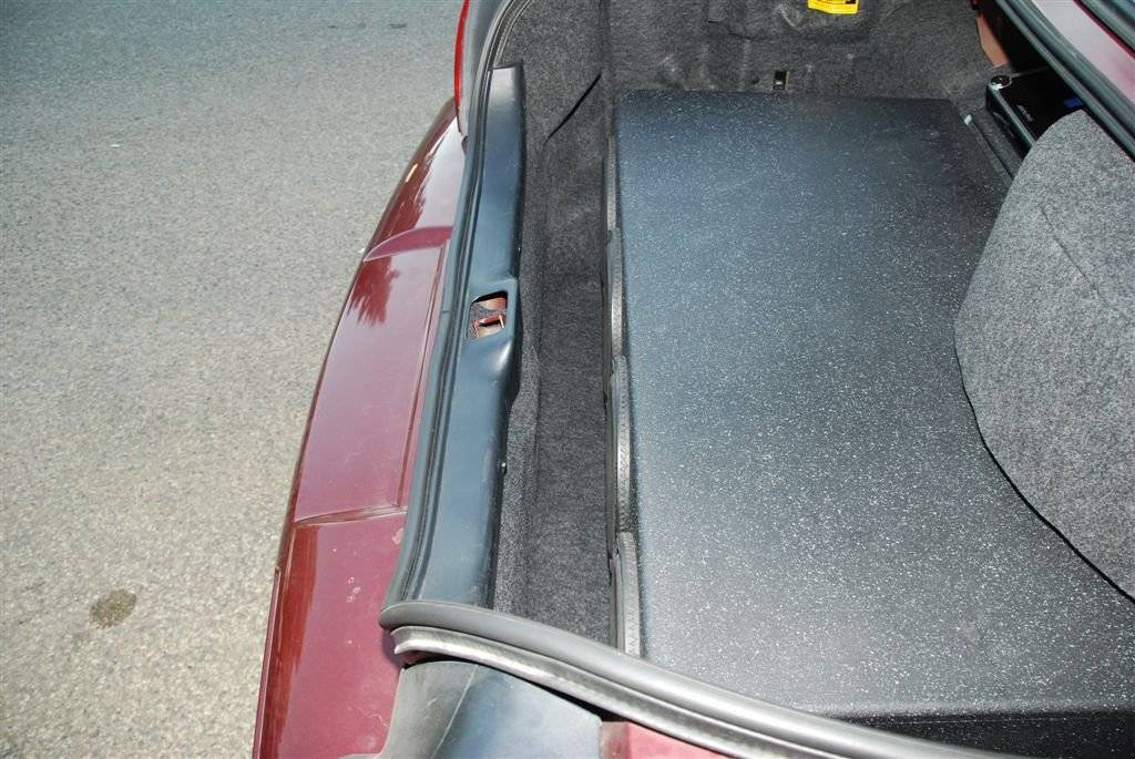

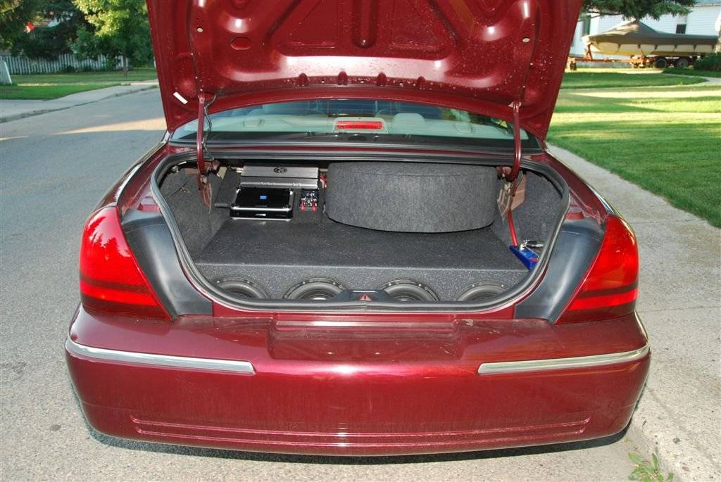

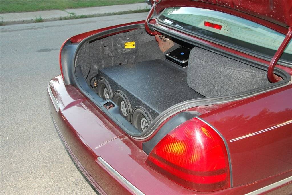

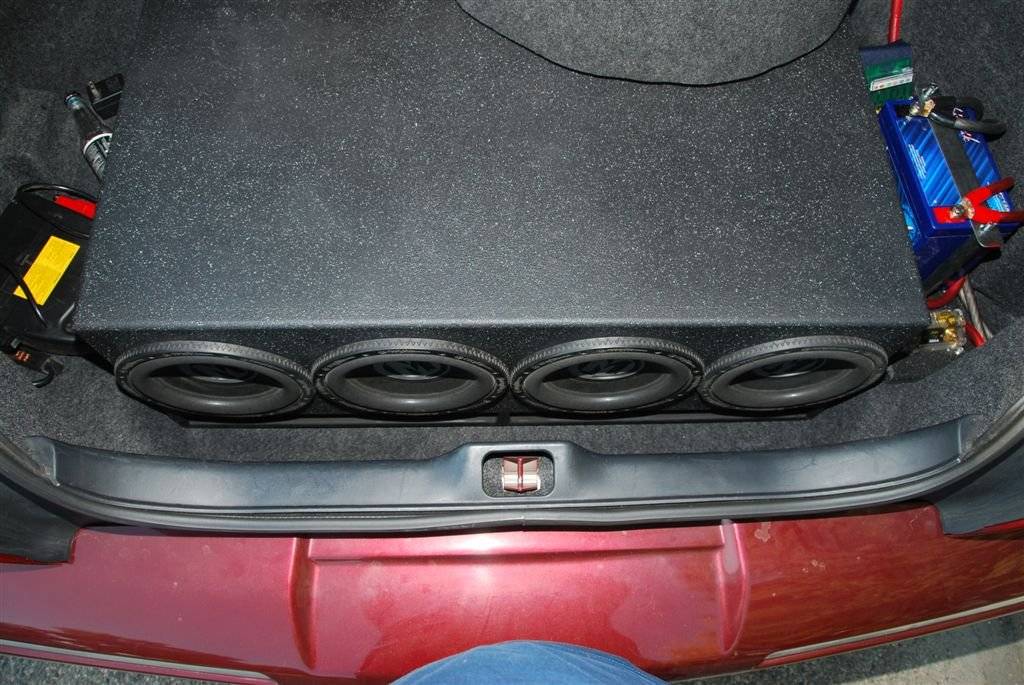

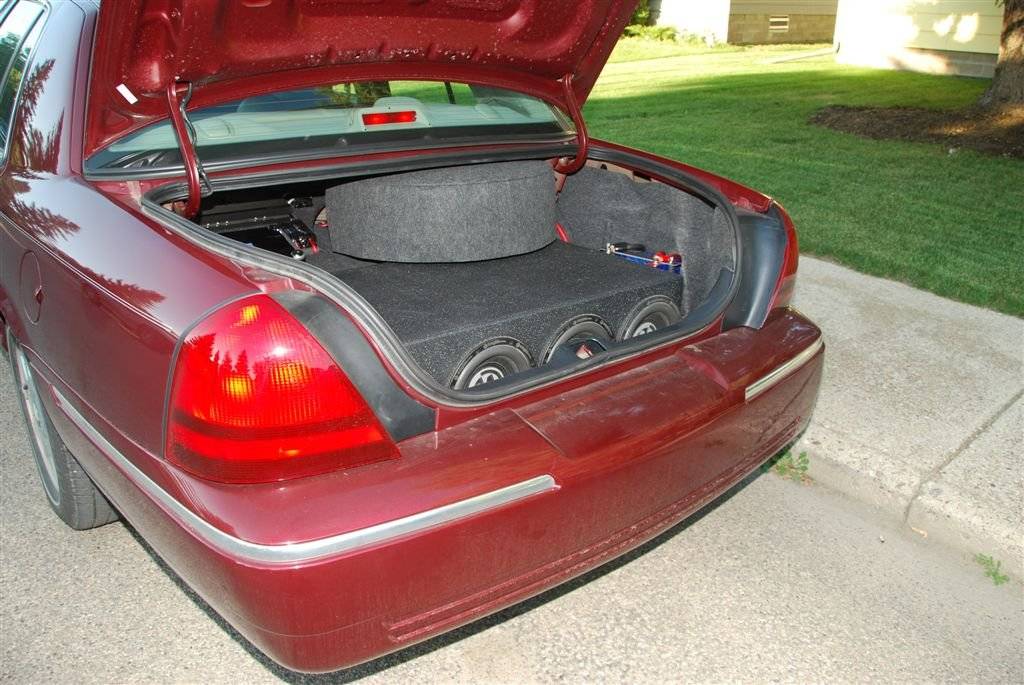

Build from here a little over a year ago, here is the link. http://www.caraudio.com/forum/car-audio-build-logs-%2Anew%2A/334371-2007-grand-marquis-ultimate-build-log-6.html
And, I dont see a issue with the Type X ported, friend has a 12" in 2ft3 net tuned to 30hz firing into his cabin, sounds nice.
