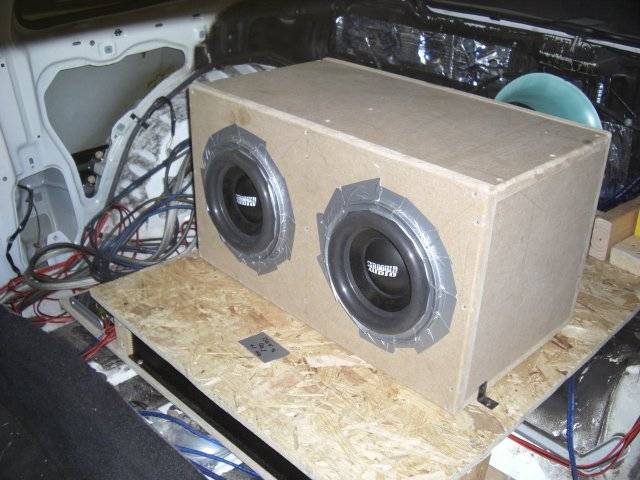

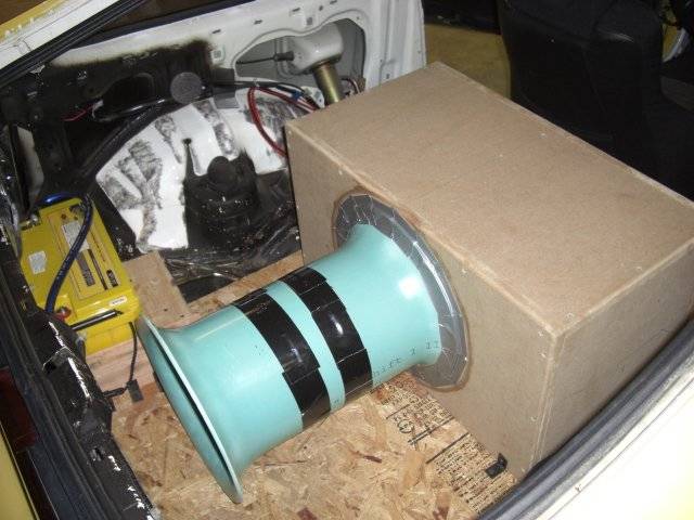

Put the two SA-8 box in the CRX modified with an 8" aero-port... finally got tuning settled in to 57 Hz as the loudest.
Powered by two SAZ-1500Ds... with one Stinger SPP1500D and one Stinger SPV-70. On Powermaster charger for testing.
Interior of car is currently gutted to prepare for sound dampening.

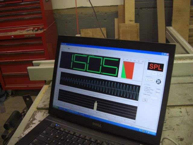

Here are the results :
Score is dB Drag style on the dash legal and sealed up.
Little FYI... bought the ports here :
http://caraudio.com/forum/car-audio-classifieds/471147-8x20-flared-ports-new-big-raduis.html
